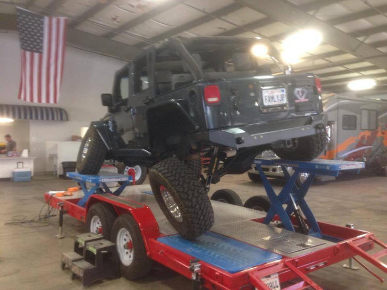

There had been some people asking for some flex measurements when running the GC with 6pak shocks. While this guy is using 14" shocks front and rear (standard is 14" front 12" rear), it gives some good perspective.
The rear tire maxed out the ramp at 48". They then raised the front 20". So essentially, the rear tire could be raised a total of 68" had the ramp been able to go that high.

Thats not how it adds up. You would have to lower the front passenger tire to find the max travel on the ramp.

Stole the math from them. But you are correct that is not proper math. At 48" the rear was not stuffed and front passenger had plenty of travel (front driver ramp left flat). It would definitely get over 60" before the front passenger picked up.
Alright, I'll do it to my Jeep within the next week and post the numbers.

lets see them! i swear on my 11.75~ i had at least 54" but i cant seem to find the pic anymore...
