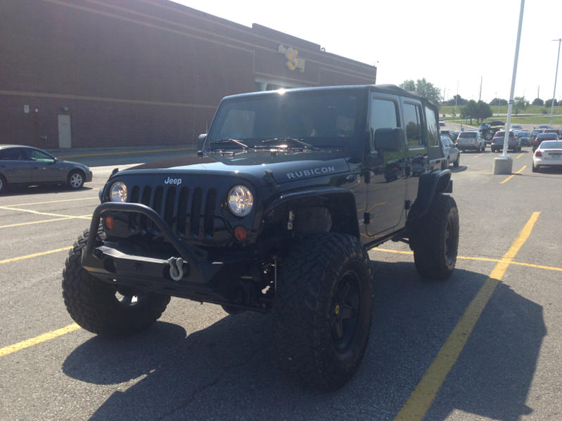

Mines pretty much the same except I have teraflex tire carrier and no bumper.
On the front, can you take a measurement from the center of the bottom shock bolt to the bottom edge of the upper shock tower. A stock Jeep is 18 1/2. Here's a pic of what I'm saying. Thanks!
Attachment 489307
Sent from my iPhone using Tapatalk 2
The Ace rear bumper is heavy so I'm probably 150# heavier in the back. The game changer shock bracket is in the way of getting an exact measurement. it's more than 22 less than 22.5 so I'll say about 22.25" or 3.75" of lift in the front. Bottom of the frame rail by the rear bumper is 25.75" from the ground.

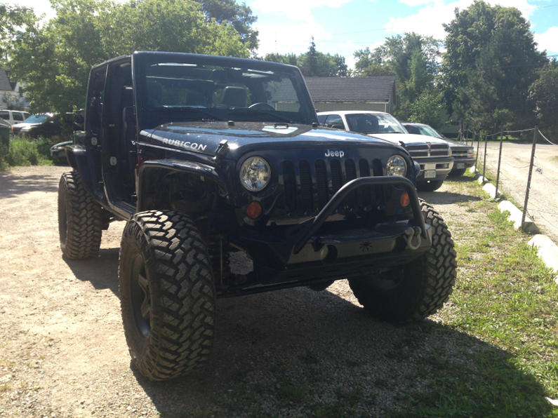

Originally Posted by Danny4652
Filthy - would you mind measuring your net lift? I have the 2.5 MC springs and would like to compare cause I'm debating swapping springs to 3.5's.
FWIW My 2.5 Gold Standard (essentially the gamechanger lite with different shocks-in my case rs9000xl) measures out at 22.25" in the front-3.75" net lift. Bottom of the frame rail in the rear is 23.75". No armor.

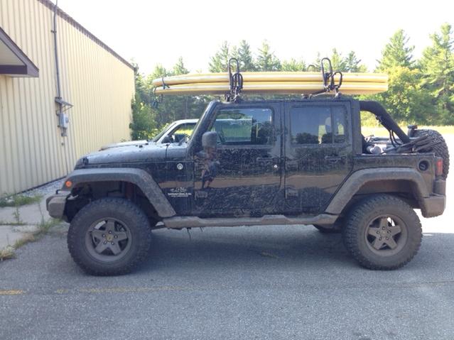

3.5" game changer lite sitting level
