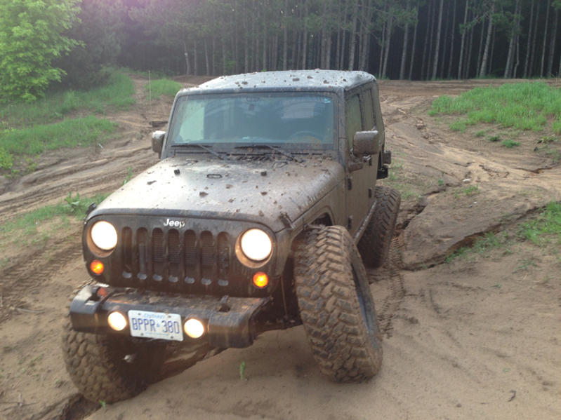

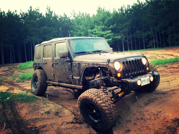

The Jeep, in the picture on the left, has air springs lift. In the picture, the lift is at its max', about 8"~9". At the time, except for the air springs and Fox shocks, everything was stock, including the arms, wheels and tires (245/75/17).
The Jeep climbed that step quite easily, just touching the right side-step.
Without that much lift, it would have sat on its belly.
