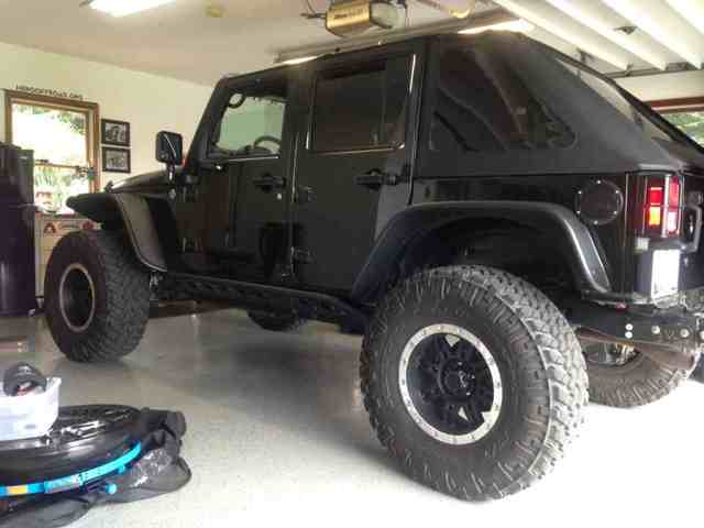

37s and 2.5 MC springs Click image for larger version

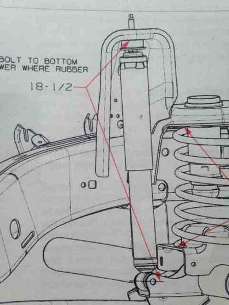

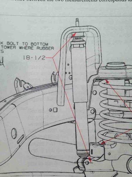

On the front, can you take a measurement from the center of the bottom shock bolt to the bottom edge of the upper shock tower. A stock Jeep is 18 1/2. Here's a pic of what I'm saying. Thanks!
