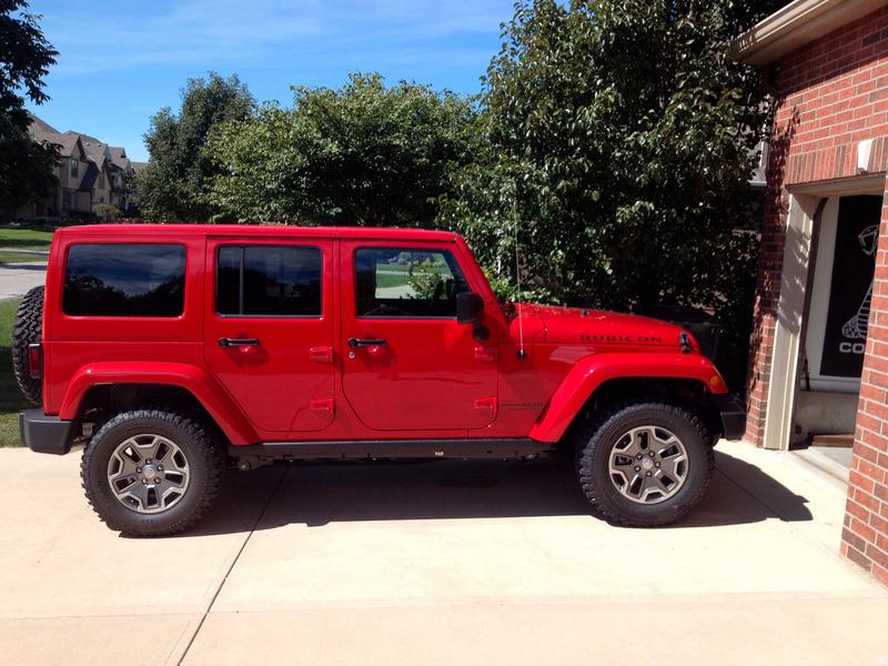

We did a 2.5 on my jk on Friday. Wasn't bad at all. Just take your time and preferably have somebody with lift experience. Brad and I helped but Jay and Brian with Stomper Offroad were the pros. A lift and air tools made all the difference. It rides and handles AWESOME. MetalCloak has designed a very complete system that works exactly as advertised.
I originally ordered the 3.5, but was shipped 2.5 springs. Stomper is going swap them out for the 3.5"s.
For those who have done the Game Changer Lite 3.5, what was your net lift in front and back?
Here is before and after.
Thanks,
Ted
Thanks,
Ted
Hey Ted,
That is a bit funny. They sent me the 3.5" springs. Guess they swapped our boxes. They're sending me the 2.5" now.
What was your net lift with the 2.5" springs? I got 4.25" in the front and 4.0" in the back. When I installed the ACE 190lb rear bumper and 90lb spare, I lost 3/4" in there rear.

Originally Posted by BigMike
Hey Ted,
Are those 35" tires?
Mike,
Yes, they are 35's. Think they actually measure about 34.5"
I don't have measurements with the same set of tires. Went from 32.5" Terras to 34.5 Trails.
Measurements are from the floor to bottom edge of the fender on the wheel centerline.
I picked up 4.25" front and rear. Just guessing, but if you take an inch out for the wheel difference, it looks like 3.25 of lift for the 2.5 springs.
