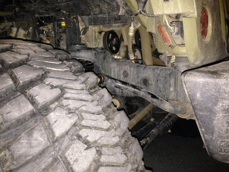

Swaybar links installed...
Attachment 514463
Attachment 514464
Final stance with level 8 ZX rick rings installed
Attachment 514465
Looks good. Thanks for the pics. I believe the instructions say to level the bar by adjusting the links. Looks like yours are close.

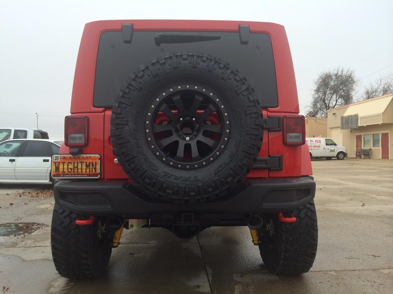

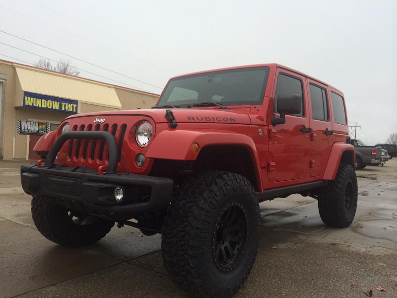

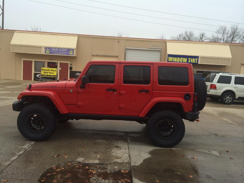

Now it sits perfect. Swapped out the 2.5 for 3.5 springs, did the AFE exhaust reroute and have ordered a new drive shaft.
Thanks to Jay and Brian at Stomper Off-Road.
Next mod is the driver modification. Will wheel this for a bit and see where to go from there.

I'd love to adjust the bars but they aren't adjustable.
One of your flex pictures, (which doesn't look full flex), shows why it gets set this way. If it started level it would flip thre wrong way.
Level would make it work better when connected, but the Rubicon e disco will not allow for full droop when set this way. Those using manual disconnects could and should set it level.
Sent from my wiz-bang time killing machine
Well that explains it. Mine is not a rubi. I got manual disco. Thanks, jnabird, for clearing that up.
Edit: My kit came with front adjustibles.
