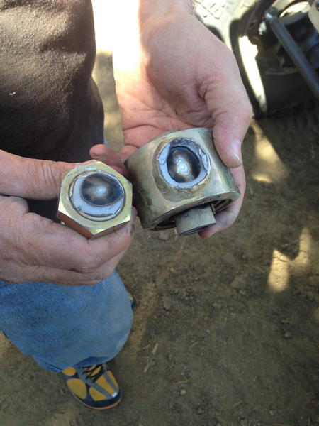

Not on mine, and I have never seen a control arm joint break at the threads to date.
Do you think this was an immediate catastrophic failure or that the weld was fatigued and finally gave? The latter would give me cause for more concern. It might suggest that joints not abused as much will eventually fail as well (I.e a matter of time).

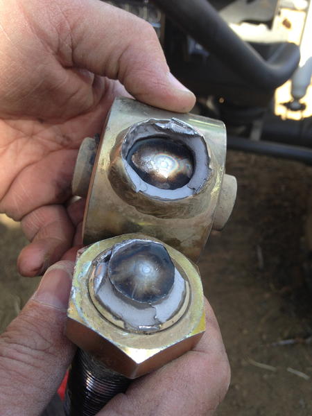

I cant tell if it were fatigue or if it was a catastrophic failure, I was not doing anything hard when it happened. Here are a couple more shots of the joint.

These have been out for years with 1000's in use. 1 reported failure on a custom fabricated suspension setup completely different than the system they were designed for. You are probably safe from it being a design flaw.

They do sell the joints seperate from kits and make no disclaimer about what kind of suspension they should be installed on. They do now state that you should use them on both ends of a control arm and will not warrentee the joint if not used on both ends.
