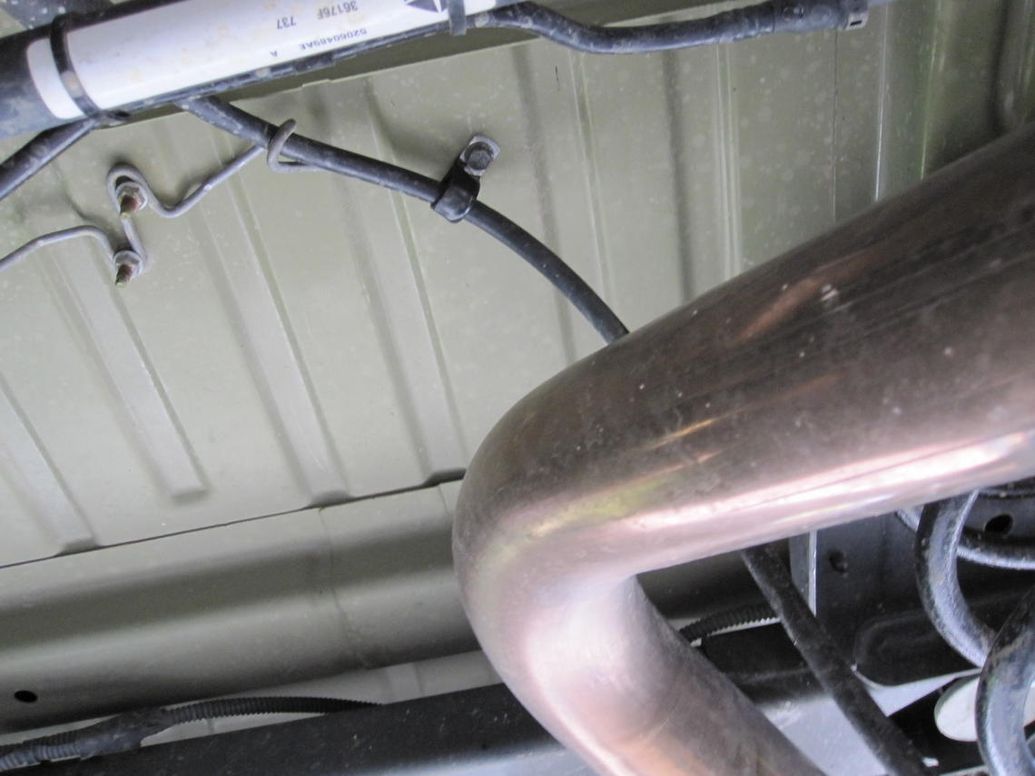

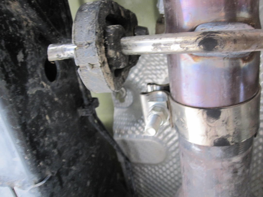

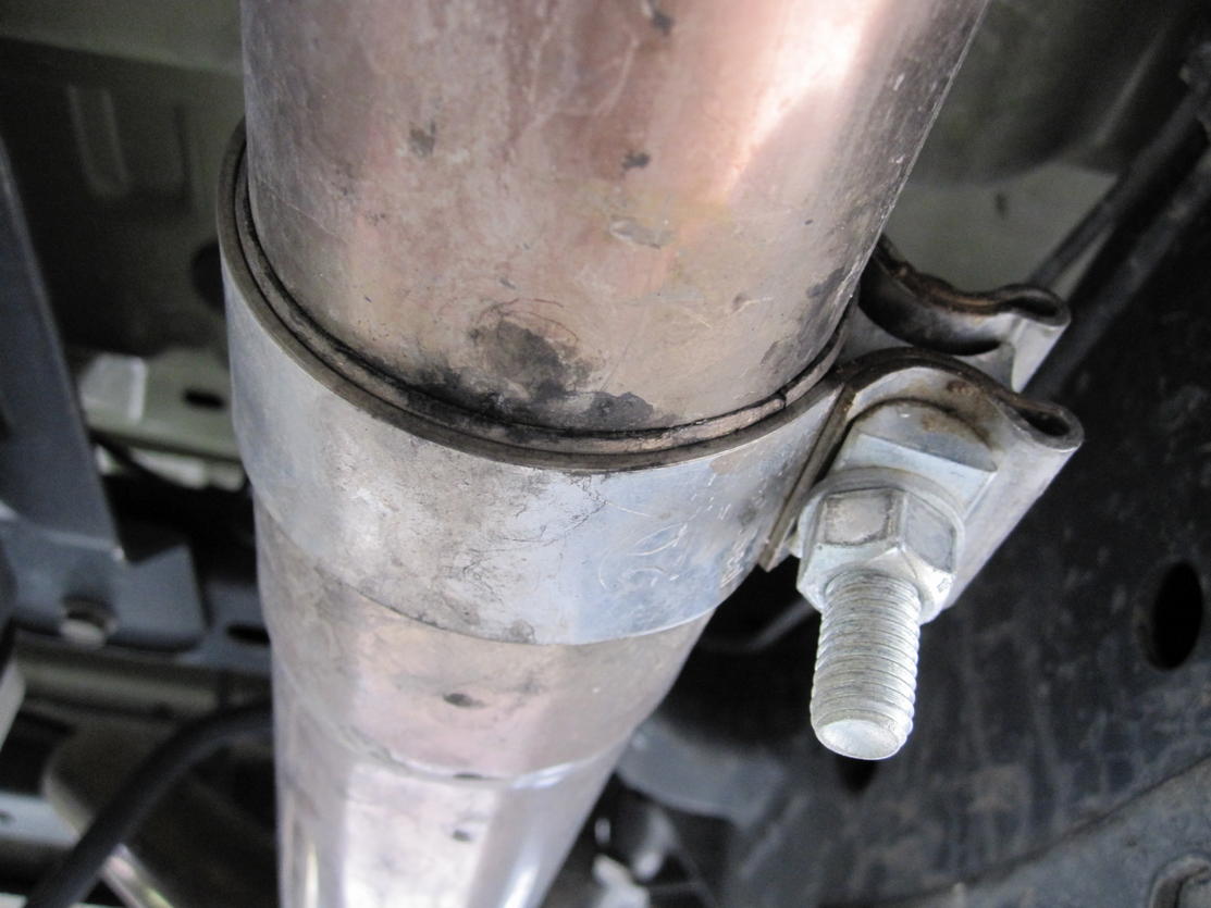

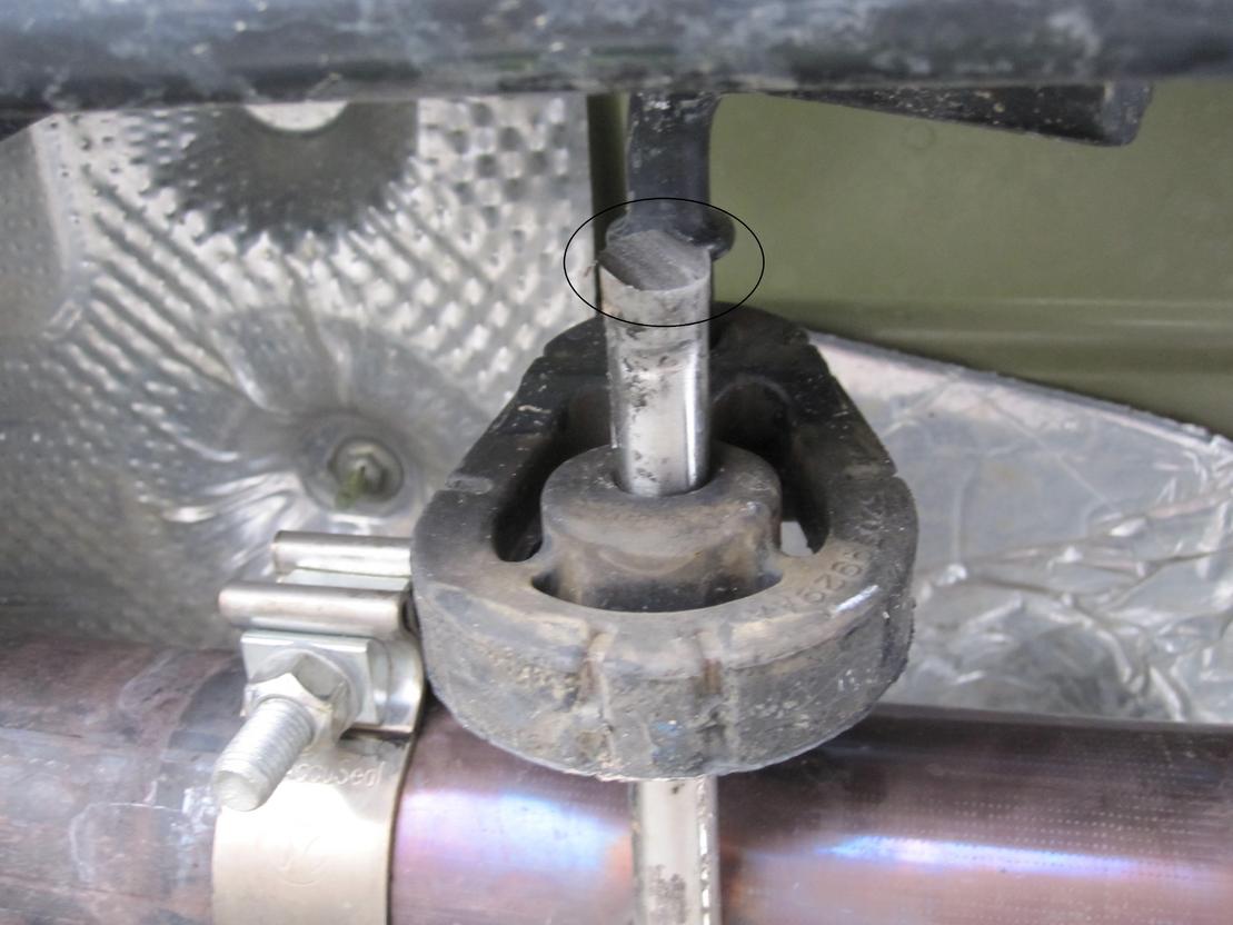

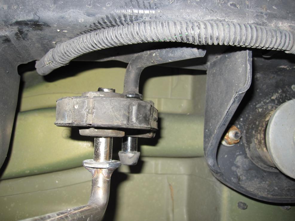

For fitment i had a few issues, two of the hangers are too long. I am not happy with the slip design(i prefer bolts and gaskets) due to leaking issues (pictures included).
After the initial test run i had a lot of pinging sounds coming from the exhaust i isolated them from 3 different places.

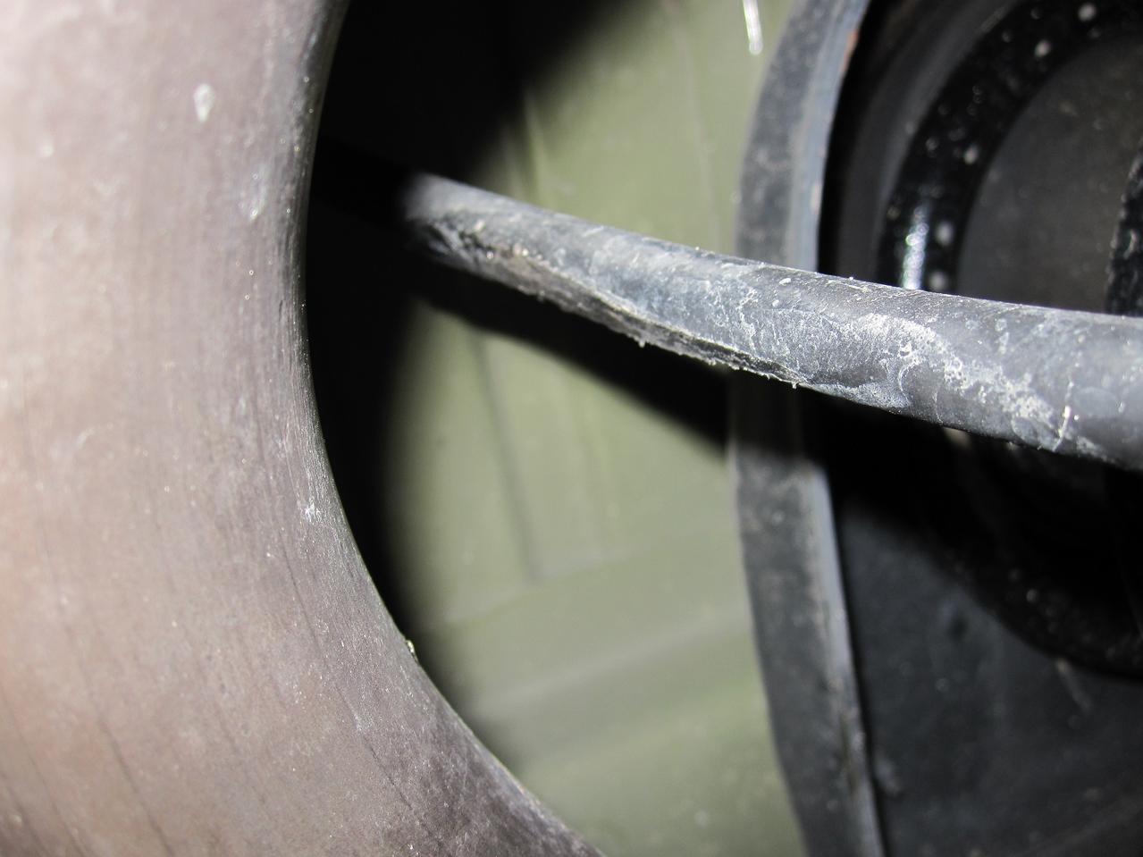

I had to cut one of the hangars away from the body frame and for now i am not cutting the second because i think with the move i did on the system it wont rub any more, but with the move on the system in caused my e-brake line to melt so i had to screw a bracket into the body that keeps it out of the way.

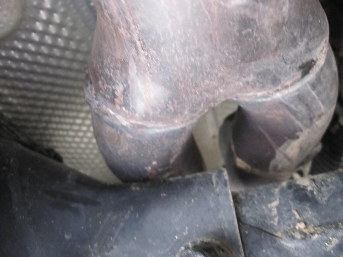

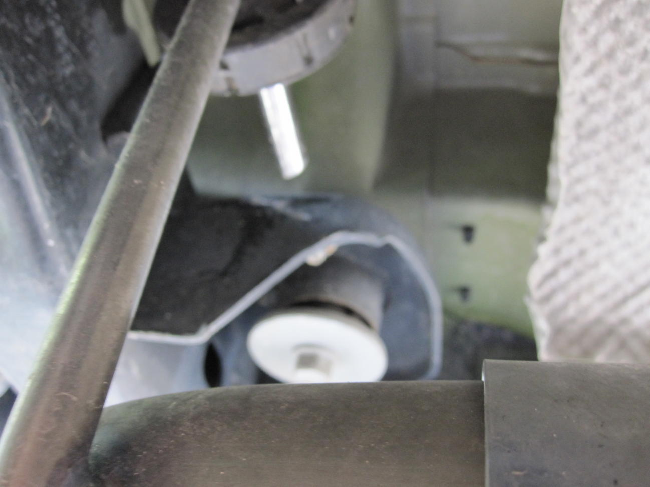

I also wondered why the factory Y pipe is so close to the frame, the engine TQs the other way so its not a big issue but there is like 1/4 inch of clearance....

To address these comments...The hanger on the front pipe is difficult to keep off both the frame rail and transfer case. Too short and it could slide out, too long it hits one or the other.
All of our systems are the slip joint style and they will seal up completely after a few thousand miles. We DO NOT recommend welding these exhausts as it makes it difficult to take them apart in the event of a warranty claim. The condensation dripping from the joints is normal.
Sometimes the system does require a little tweaking after a few heat cycles, and the e-brake lines do need to be bent up and out of the way. The bracket holding them to the floor of the Jeep can be bent and we've never had any issues with installs done in house.

Thanks for the timely response. I know what you’re talking about with the frame, I thought originally that where it was vibrating, but with a VERY TRUSTING friend I put it in reverse with the ebrake and holding the brake and we found exactly where the issues were.
I still think yall should shorten the hanger in the front and the one at the very end by about 1/2 an inch. I think you should either lengthen the one right after the large U bend or weld small tips at the end of every hangar (which is what I am probably going to do myself)
ALSO thank you for the info about it sealing up after 1000 miles or so I figured a few heat cycles and I would tighten them again before I put that muffler gook stuff that makes a good seal (but a PITA if you ever want to take it off).
I started by bending the ebrake line up with the stock wire thingie (have no idea what to call that thing) but it was more efficient to use another bracket to hold it, IMO.
Again I love the sound and HP/TQ, i am just used to different setups. And although I am new to jeeps, im pretty experienced with exhaust. ever take an up-pipe out of a wrx? its a major pain!

I would still like to know why the Y-pipe is so close from the factory??? It seems like I could modify the mid-pipe and have the hangar "assist" in keeping it further away. My buddy said the engine tq's the other way so its on an issue under load, i just thought it was pretty weird that they put that plate so close.

Also - my pipes sealed up after about 1000 miles. after 2500 miles, the sound reaches its full deep tone.

I cut about 1/2 inch off my hangers off last week and got rid of one nasty rattle-other than that I like mine.
