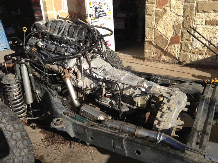

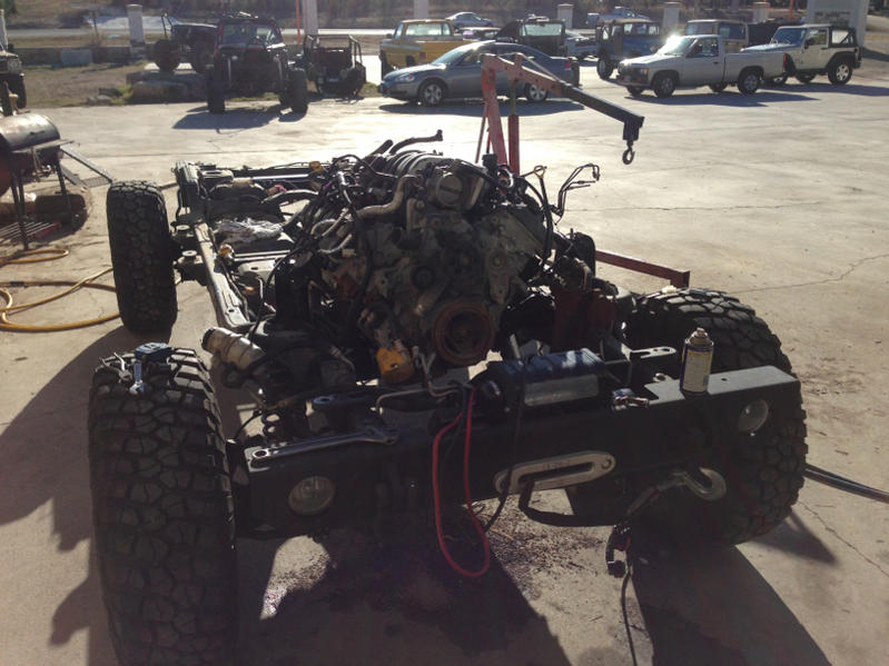

Hemi being installed now and should be finished by the end of the week, pending a few parts on order to finish install.

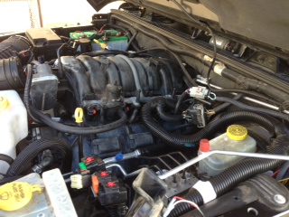

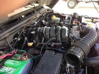

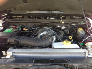

Well we finally got this beast to start with some help from AEV engineers, we had to send the AEV computer back because it was the wrong one for my engine( it would appear that I have a non-VVT hemi, go figure!). Once the new computer came in we hooked everything up and she fired right up. Now my gas mileage isn't worth a crap(12 to 13.5 mpg) but it's a HEMI for Christ sakes...lol. Anyway I'll get with AEV in the morning and see if there is anything I can do about that MPG issue and I'm wondering if my SuperChips Flashpaq will work with this new setup? The procal that came with the hemi kit is very basic with its functions. Also maybe someone on here can help with how to identify a VCT hemi from a VVT hemi?
