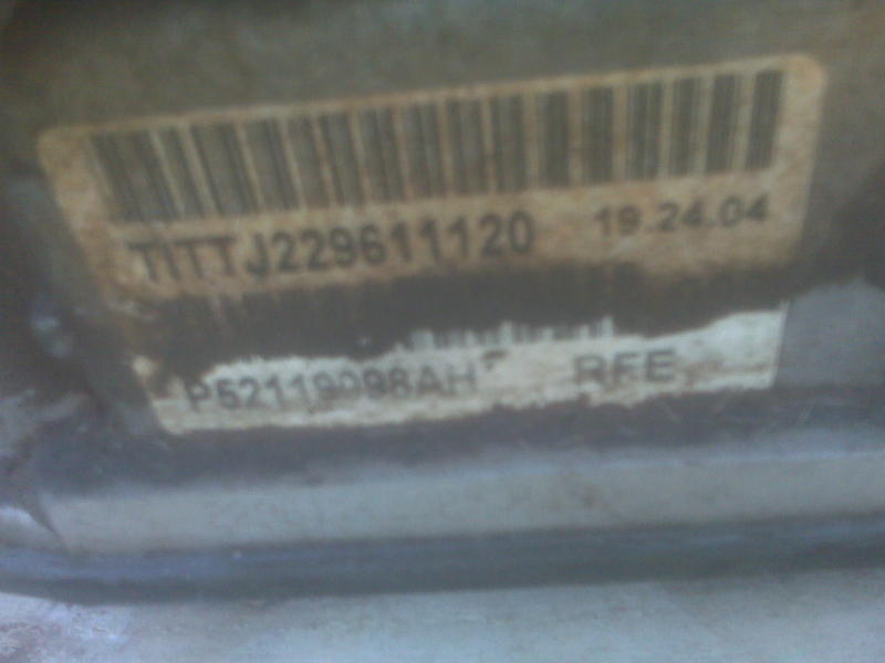

Originally Posted by JKcondrey
Check the plastic label above the oil pan on the trans. Look for RFE in the numbering. From what I can see it is definitely a 545. The only issue is the tail shaft. That trans is setup for rear wheel drive. That commander had to be 4x2. If aev said the body had to be replaced it may be due to that. However, I could be wrong, but I believe the tailshaft can be replaced with small section that is bolted on at the rear. That is where the adapter bolts on. So that may be what they are referring too. Mine had the durango adapter for the transfer case that I removed. The mopar # on my invoice is 52119433ab. The seal for it is #52119498aa. Again, these #'s can change. I ordered it from moparpartsamerica.com for about 73$. You must order online though to get that price. Otherwise dealer cost is over 100$.
I have been told the 1310 shaft will be fine for most folks. That is what i intend to put on myself later this summer. Ive got very little room right now after the exhaust is routed around it.
Yep, you're right it is a 545 tranny and here's a pic of the tag I found on the tranny to verify it.

Well it's confirmed, the motor and tranny is out of a 2011 Jeep Commander according to Chryslar. I can now order my conversion kit, so far I have to order the conversion kit (AEV $5,400.00), the tranny adapter ($215.00), Seal for the adapter ($20.00), New Valve body for the tranny conversion ($500.00), Valve cover ($120.00) and Coil pack ($25.00). For a total of $6,280.00 plus or minus other parts like belt and fluids and stuff. Oh well guess I'll start order and get ready for the swap of a lifetime .
