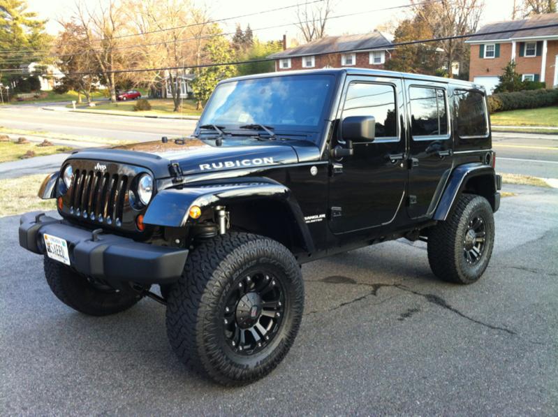

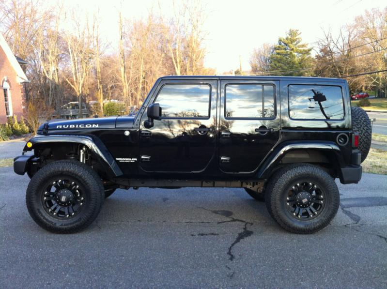

Meant a pic of it head on so we can see how the tires look when it's "straightened" out...

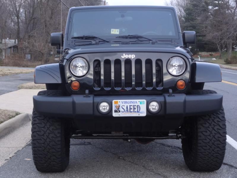

Originally Posted by UAE455
<img src="https://www.jk-forum.com/forums/attachment.php?attachmentid=274309"/>
<img src="https://www.jk-forum.com/forums/attachment.php?attachmentid=274310"/>
Looks as if your left tire is pointing a bit to far left. Try the do it yourself alignment (tie rod) and pull it in...
Old Feb 5, 2012 | 02:07 PM
  #68
Battlefrog's Avatar
Posts: 3,449
From: Newport news, va
Driver side tire....
