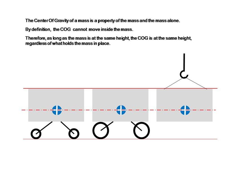

issue# 2 yes, both have the same height and different centers of gravity due to control arm geometry.
No need for tables or calculations, this is basic physics.
If there is anything wrong in the following sketch, please point it out... :

While rushing to reply, you missed the point. No need for tables or calculations, this is basic physics. If there is anything wrong in the following sketch, please point it out... : <img src="https://www.jk-forum.com/forums/attachment.php?attachmentid=509999"/>
That diagram is at rest.
It is incorrect when the vehicle brakes, turns, climbs or descends while in motion. It doesn't consider leverage or arc of travel when the suspension compresses or extends. It doesn't include the effect of 4 links on a rotated axle.

This is another example of you going off the rail with totally irrelevant information in regards to suspension systems and how they work. This just adds to confusion.
After reading this write up you seem to have some kind buyers remorse in the fact you went with a 4" lift and are trying to justify it with nonsense.
No where in the write up says you are wrong with running more lift then needed it only states that there is very little gained by doing it and will cause other things that can be detrimental to performance both on road and off.
The intent of this thread was to help people that have little or no knowledge of lifts or what the individual components do with an honest easy to read write up on bolt on lifts for the JK. I was not intending to give a class on suspension theory and design. I made reference to playing with a 4 link suspension calculator to see how different heights affect the performance of a vehicle in motion for those that are interested. The calculator will give you numbers and graphs to look at that will verify the information that has been given.
