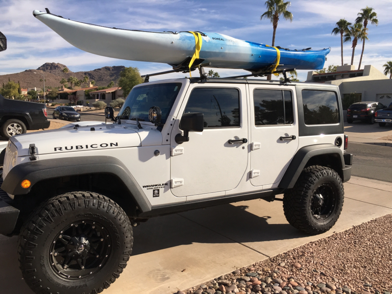

Thank you sir, how much did your setup run you excluding the wheels and tires? did you install yourself? can u post a pic of your rig?
Old Mar 5, 2016 | 11:44 AM
  #610
WHT_JKUR's Avatar
Joined: Nov 2014
Posts: 466
From: Phoenix, Az
AEV kit (lift, shocks, etc) was about $1300 total when you include drop brackets and procal. Wheels and tires were about $2300 (for all 5), but I was able to get $600 for my stock wheels/tires that had 7k miles on them. So a total net of about $3000. I could have probably shaved about $400-500 off if I had done with cheaper wheels/tires, I did have someone do the install for me for about $700 (as I recall)
Got new Yukon gears and basic rebuild kits for about $575 from a forum vendor. I had some other work done on my axle, but labor for for the gears was probably about $600ish.
