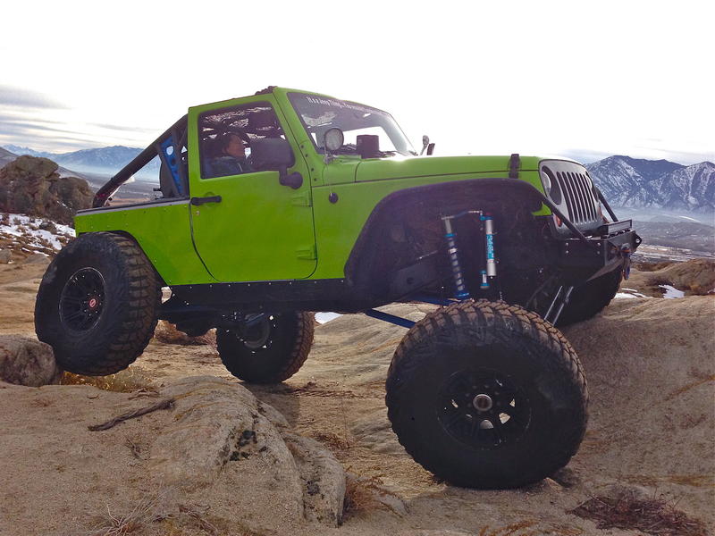

The most impressive jeep built I have seen was a 2008 JK 2 doors, 10'' extended wheelbase, 2.5'' custom long arms lift, king coil over with 12'' of travel, 40'' BFG Krawler tires, full float axles, etc. It was a purpose built road legal rock crawler… I was impressed how this jeep could run 40'' tires with only 2.5'' lift but the level of modifications required to achieved that is out of most budget.

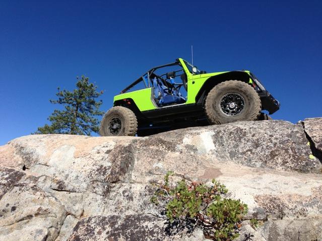

It would look something like this but I am stretched more and have 14" travel up front and 16" in the rear.
