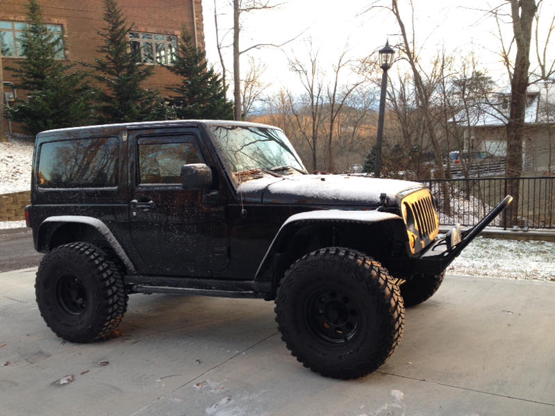

Not towing anything here, but with spare and loaded down(hardtop plus 4-500lbs in the rear) mine sits level with 19-59 springs. Take all this off and she has about an inch of rake. The springs are stiffer, but they don't handle a lot of weight.

Hmm, so about 600 lbs in the rear will drop the back end about an inch with 19-59 springs?

This picture shows there's not much rake when mildly loaded. So carefully choose based on what you'll carry. I think I gave you pretty good numbers.
That and hardtop for sure
