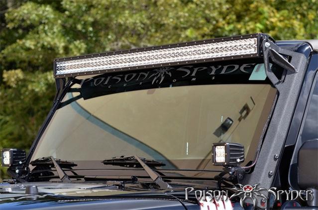

Need some input i am looking in to getting Rigid E-Series 50" LED Light Bar & JK Light Bar Mount from poison spyder site but i have rugged ridge mirror relocation set up and it looks like they will be in the way of the light bar mount any one have ideas how i can run with both on my rig?
ID:	279936Click image for larger version
Name:	Relocation Brackets.jpg
ID:	279937 here are some pics

Put the light bar on first than the mirror will fit

won't the bottom of the light bar stick out to much?

it's about 1/4" thick so nothing really noticeable. But you will need a rubber spacer of some sorts to make it work correctly. And you may need longer bolts, I had to use longer ones when I stacked A pillar mounts over the poison spyder mount.

Any pics? Where is the best place to run the wire in to the jeep?

Haven't really gotten around to taking decent picks yet since I just installed it 2 days ago. The wiring is kind of a bitch to hide you can tuck the connector piece up on top behind the bracket that holds the bar up and the wiring tucks away behind the actual bracket itself. I cut away the thick black covering to make it easier to hide away, its not gonna affect the weather proofness of the wiring at all.
