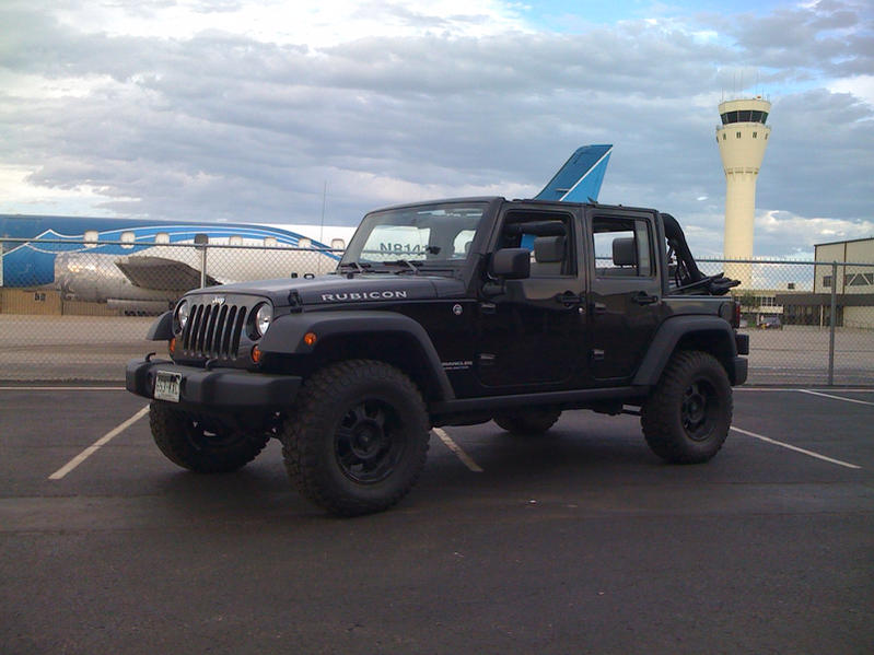

Go with the 285 and make sure the back spacing on the wheels is 4.5" or less. I ran 285/70/17 on the stock suspension and at full flex it didn't rub enough to damage anything.
Old Apr 28, 2014 | 06:24 PM
Ncb's Avatar
Ncb
Posts: 1,087
From: Parker, Colorado
Couple pics for reference.
