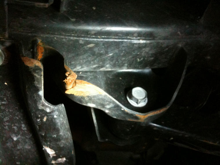

by the way, for those of you who will actually use your jeep to go wheeling, may i remind you that a good line is often times one where your tires are climbing up and over obstacles instead of dragging them underneath your belly. of course, by virtue of this, your frame rails and rockers often times become the lowest point of your jeep and take the most abuse as they should. and, this is why so many of us lift our jeeps - so that we can RAISE the lowest points and provide more clearance. so...... would someone please tell me again why LOWERING your control arm mounts as opposed to installing heavy duty adjustable control arms with highly flexable joints is such a good thing?
oh, here's a shot that i just took of my passenger side control arm mount at the frame. as you can see, even with 4" of lift, i've still managed to hit enough times and hard enough to bend and tear it. the driver side isn't much better and just about everyone i know has mounts that are beat up too.
of course, i can only imagine how much more i would be hitting my control arm mounts if lowered them. but hey, if you don't intend to wheel your jeep, i suppose none of this really matters.
