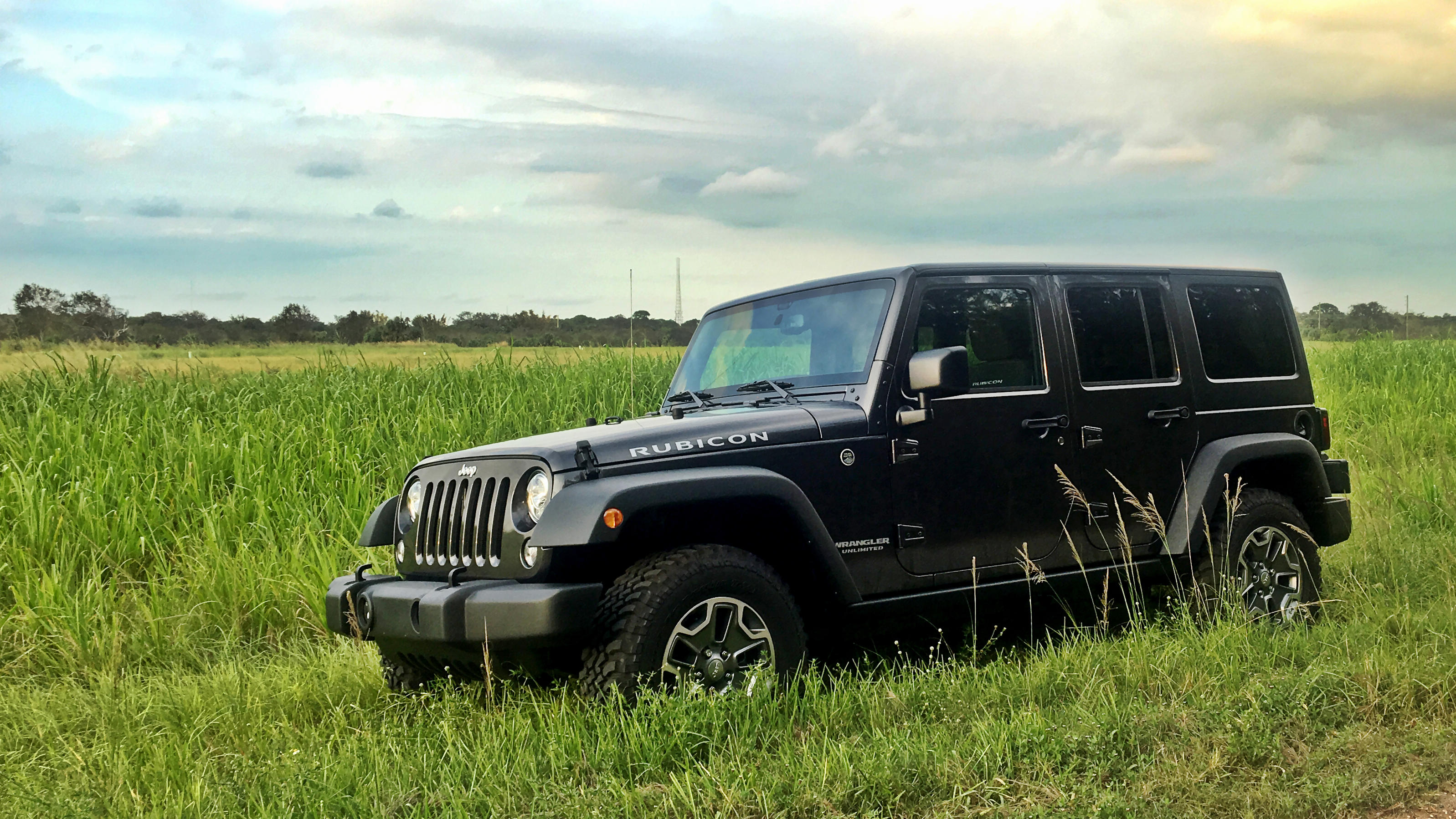

So, I bought a JKU sport S last year. It came with a 3.25" rough country lift.
I live in FL, Long story short it was stolen and totaled during Hurricane Irma.
Sooooo now that I'm sold on a Jeeps, I went to the dealership and came out with a Gorgeous 2017 JKU Rubicon granite crystal! Manufactured Aug 2017.
Now that I'm looking for lifts I realize that there are so many choices, and even more opinions.
I have a set of wheels with 35's(Toyo Open Countrys) that... for now work...
35's work long term, I like the look, I like the height of my last jeep... what I think could improve was drive-ability.
Cost is not a big deal I'm willing to spend a couple grand no problem, as long as I get a better lift.
I'm in Florida so I'm not doing any rock crawling, but I do encounter mud and water a lot, and its my daily driver so on road performance I would like to keep.
I have read alot of post and understand trimming the rock rails is probably a must. I havent seen any info on sway bar disconnects is there anything I need to be aware of when choosing a lift that will effect that?
I also will most likely be adding bumpers and accessories in the near future, so weight will be added.
as it sits now it drives so much better then the last jeep, I'd like to keep that as much as possible.
Ive heard that the JKS JControl is great, but I have also seen that many on here are happy with the AEV 3.5"
So many choices...
any help from anyone that lifted a Rubicon is appreciated, Looking Forward to this build!
