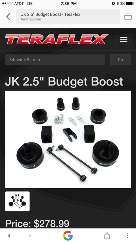

U don't need a 3.5" lift for 35" tires. 2.5" is more than enough with stock fenders. 1.5" lift with trim fenders will fit 35" tires. So if working on a budget, u would be better off with a body lift or budget boost lift. Then add other components if needed.

Old Jan 23, 2017 | 03:37 PM
shawnphi1's Avatar
Joined: Dec 2013
Posts: 164
From: Gahanna, OH
