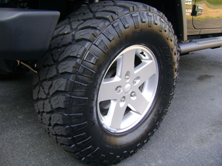

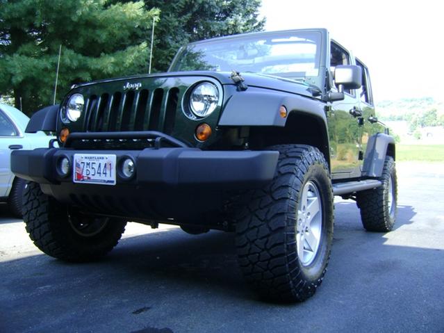

I am also new to this forum and I will say (for the most part) that the members here are very helpful and have alot of experience. I just completed some mods to my JK and it seems that we are in similar situations. Like you I was looking to do some modifications while keeping it within a budget. If your looking for a reasonably priced A/T tire you may want to take a look at the Kelly Safari TSR. I just purchased a set of these and, so far, I am extremely impressed. I checked the forums and could not find much info. on the Kelleys. I went with them because I liked to look and price. To my surprise they have a comforatble ride and handle well. There also very quiet for such an aggressive A/T Tire. As for a lift, I listened to the forum members and spent just alittle more money on a 2.5 inch coil lift with shocks rather than a BB. It was money well spent. I think my JK actually rides better than stock. I got rid of that spongey feel and now have less body roll in corners. All in all I spent approx. $1600.00 bucks on the lift, wheel spacers and tires (I kept the stock wheels). I had to spend a little xtra on the lift because I had the dealership install it so I could keep my warranty. My advice would be to listen to the forum members (especially the moderators) and keep in mind what YOU are going to do with your Jeep. Good Luck with your mods!!

Thanks for the info Danny I'm glad to hear you are happy with the lift. Do you hyave any adjustable control arms or trackbars?

Not right now. I think I'm going to see how much wheeling I do in the future. Being new to this game, I'm learning as I go and dont want to destroy my new ride
