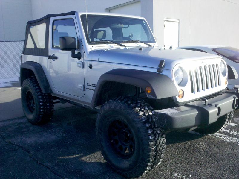

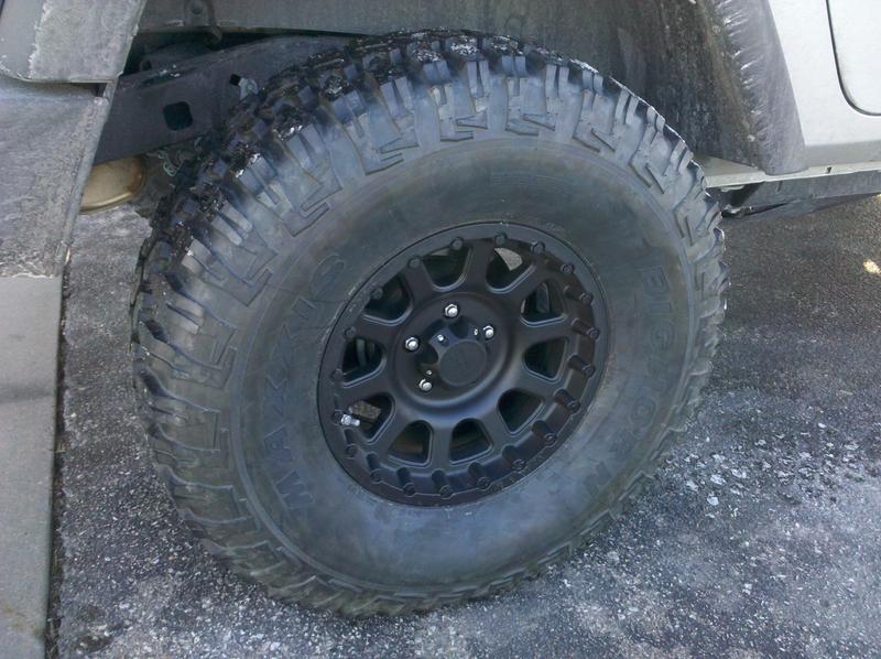

Default Uhhh nevermind...
Never mind... the studs were fine. I work at a volvo dealership and one of the techs was just freaking out when he saw the wheel on there, he's used to volvo's... They fit fine.

And for future ref I've learned
1) our jk are so new that you can only get new lugs at the dealer, not the auto parts store (ask me how I know-installer using impact wrench when installing)
2) they make a large selection of after mkt lug nut u can get at parts store. Ont only do they have the kind with tapered ends, but they make some that have 1/2 inch of front thread, THEN tapers for even deeper bite onto the lug. This helps if u have wheels with odd offsets
