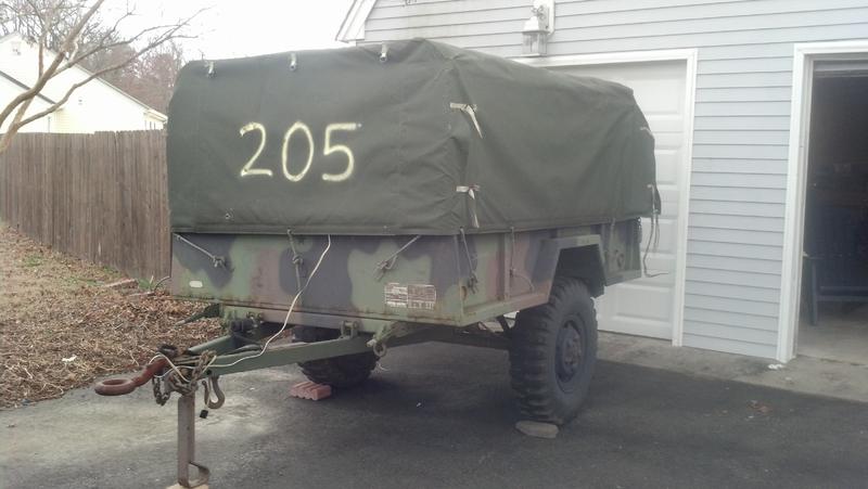

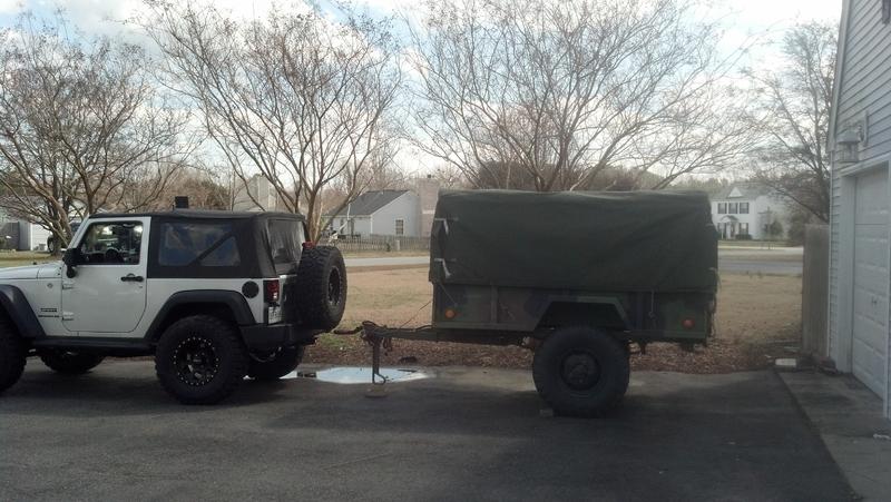

here is my trailer I got a few months ago. its going to be my winter project. I am going to swap the axle for the one that I can run the same wheels and tires that I have on my jeep. Debating on painting it or bedline it. I have a few months to make my mind up.

U gotta swap whole axel ? Is that hard to do
You don't have to. But the one thats on there is very heavy. The whole trailer is pretty heavy, so it makes sense to try and lighten it up where possible. Yes, if you're going to swap the axle, you swap the whole thing. Yes and no. The stock axle isn't that hard to remove, but you'd have to remove/disconnect the stock axle brakes (those are kinda nice).
As for the actual work... no not hard, it's just some bolts.

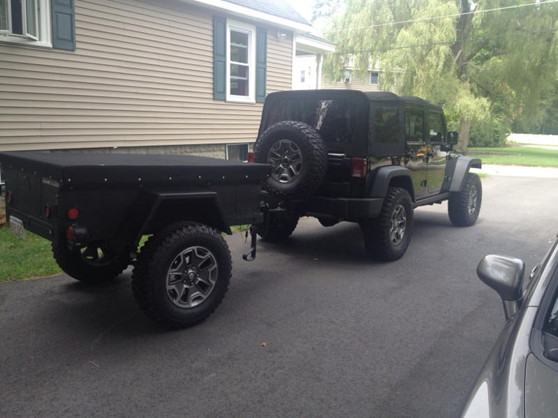

<img src="https://www.jk-forum.com/forums/attachment.php?attachmentid=505786"/> My set up. Nothing crazy but gets the job done.
Very nice M416 with modern wheels!
was the bolt pattern a match, or did you convert the hubs?
Very clean, nice cover.
It's exactly what I have in mind

Originally Posted by blown2tone
Very nice M416 with modern wheels! was the bolt pattern a match, or did you convert the hubs? Very clean, nice cover. It's exactly what I have in mind
i changed out axel in order to run wheels. It was cheaper and easier to do
You can also get adapters to go from the stock axle to the 5x5 pattern. Cost me ~150 inc shipping. Allowed me to keep the stock park break (which is nice) and have matching wheels.

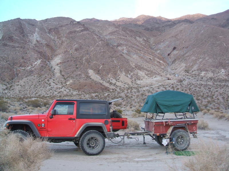

I bought this in January, finished rebuild and mods in April, then took a 3,000 mile trip to Moab, So Cal and back.

Originally Posted by Rubi55
Attachment 505786
I like this one. Details?
