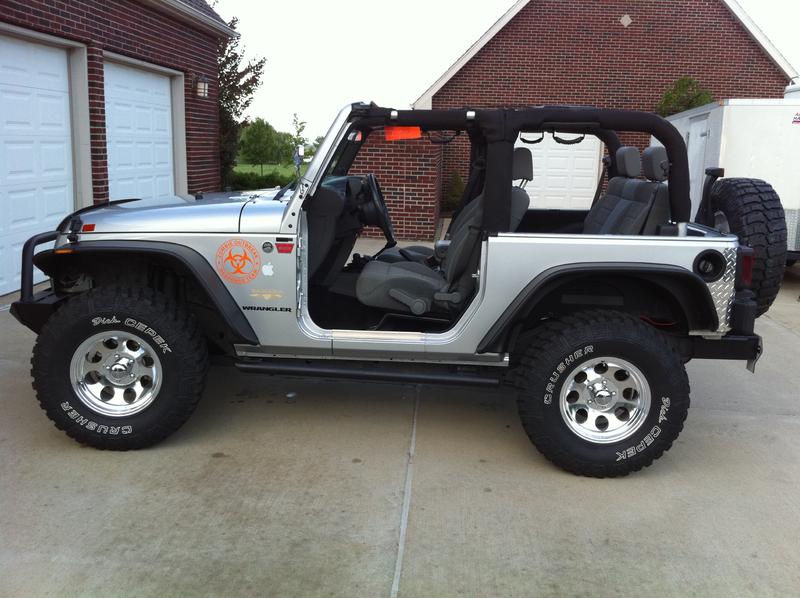

They are bushwhackers and not trimmed. Tires and the fenders were the first mods I did on the jeep.
Dang they look spacious.

Originally Posted by TheDirtman
I ran both the HD and and no load coils on my 2007 JK, the HD gave me about 3.5" of lift, the no load ran about 2.5" and rode much nicer. I was running their nitro sport shocks at the time and was pleased with the results and ride quality. I had a warn 8000 winch and a heavy steel bumper. here is a shot with the HD coils with bushwhackers and 33" tires.
Attachment 593852
Sweet setup. Did the no load coils make your jeep level or did you have some foward rake? Would the no load coils minus about a half an inch still give the suitable advantatages of a lift? I need the ultimate on/offroad jeep.

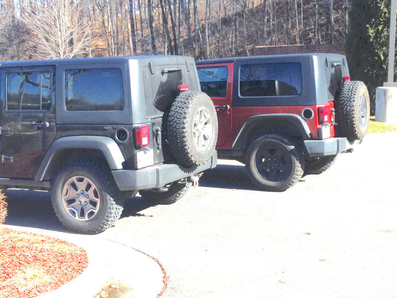

Nice. Here's mine next to a co workers. Flats give tons of room.

I never had an issue with rake and could not tell you for sure if it had rake or not with the no load but the ride was much better.
Attachment 593897
yes here is 1.5" lift with 35's.
