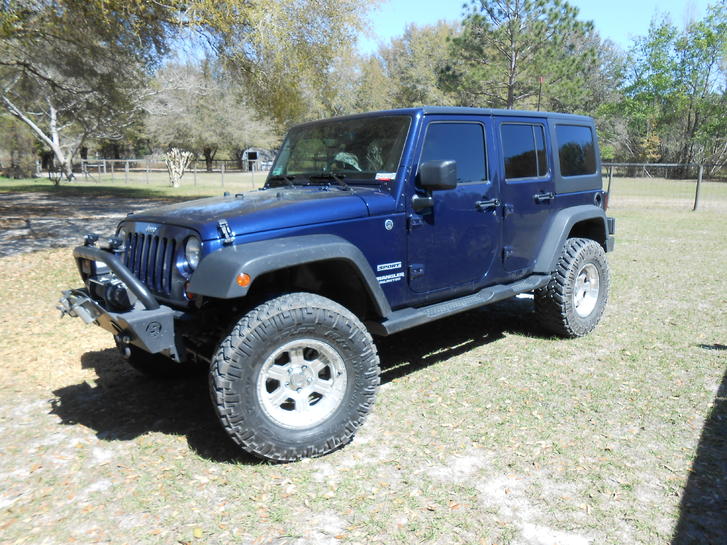

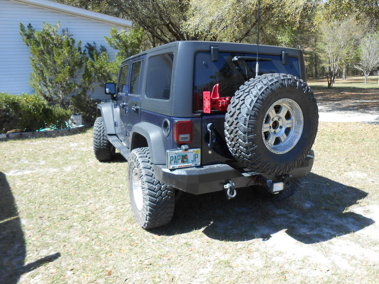

ID:	435498Click image for larger version
