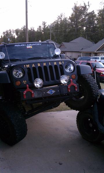

Personally for what your lookin for, Rough Country's 3.5 runs about $500. It has everything you need and the ride is awesome!
