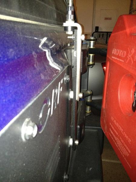

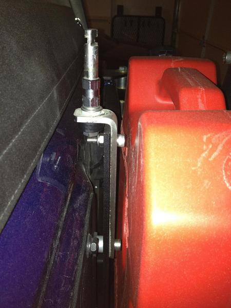

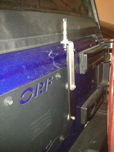

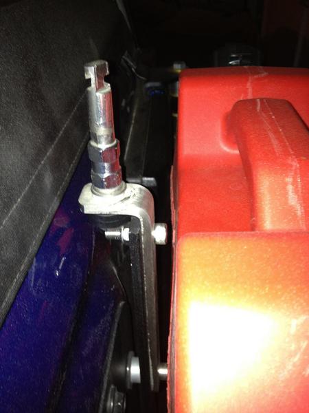

I have a cooltech mount and it did not work with my rotopax orfab carrier. So I got a 12 inch piece of steel and drilled 3 holes in it to mount it up higher. It works fine now. I have about a quarter inch of clearance between the mount and the rotopax. I currently have the L bend facing inward, but it does fit outward too. When it is facing outward it covers the rotopax a bit, but it still fits without touching the rotopax.
UPDATE. I talked with my friend with the Teraflex cb mount and the Jerry can Orfab carrier. She said the can rubs on the cb mount, but some filing or grinding of the mount would fix it without hurting the mount.

In this picture, the distance between the gerry can and the tailgate is at least the length of the stock tire bump stops. And I know the TF cb mount is shorter....
Honestly I don't know the space difference between the rotopax and jerry can versions. But I would guess from talking to people that the Jerry can version may have slightly more room for the cb mount.
OP - Looks like it should work it you asked me.
