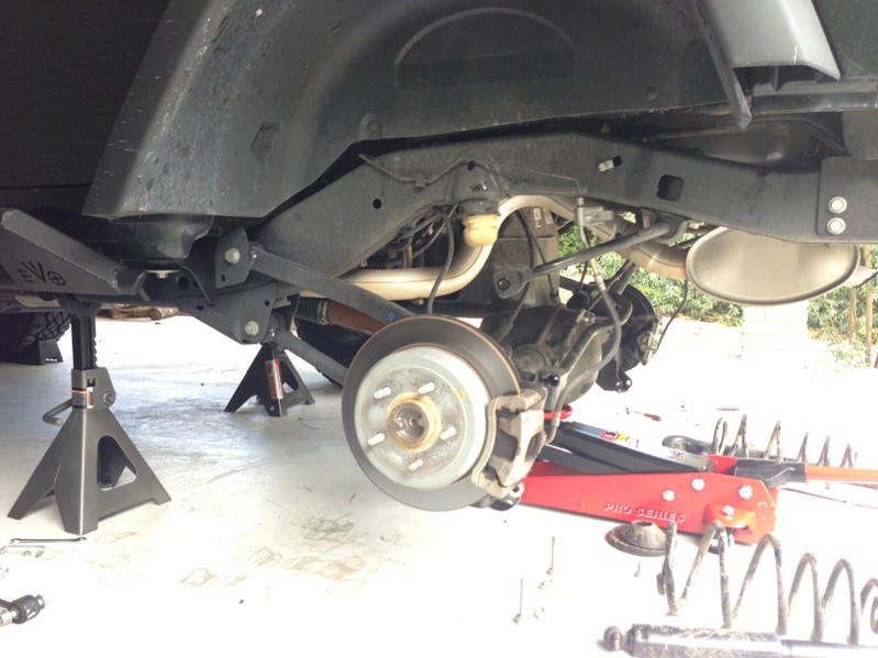

correct. 6-Ton stands. and. new 2.5T jack. got the rear up in the air at 3p EST. stock coils popped out at 4:15. hoping ill be done by 7:00. :\
Old Sep 18, 2013 | 12:20 PM
  #49
rodi's Avatar
Posts: 326
From: Atlanta, GA
about to start drilling.
Old Sep 18, 2013 | 12:23 PM
  #50
scooby snacks's Avatar
Posts: 4,343
From: Wake Forest, NC
Let 'er rip!! HAHAHA!! As long as you line up the drill with the paper template you'll be good to go!! Good luck!!
