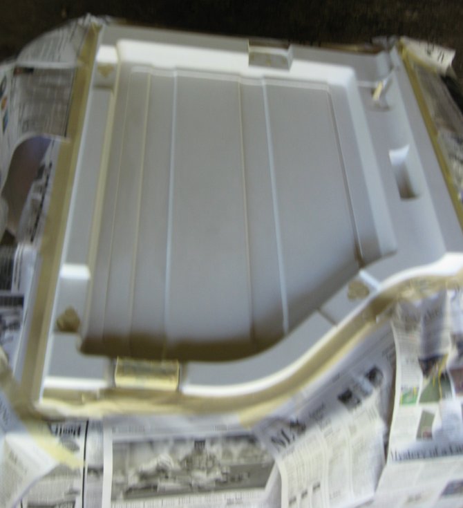

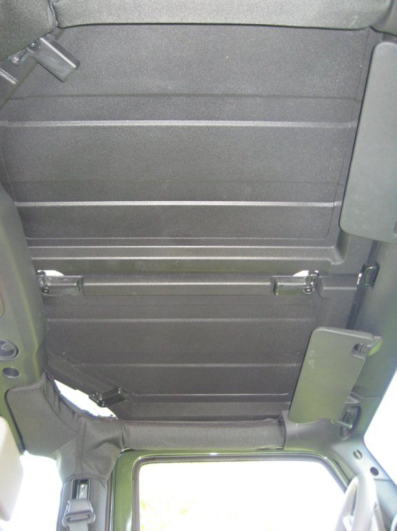

I have a 2 door Sahara.
Bought 7 cans of Duplicolor Truck-bed Liner
2 rolls of masking tape
220 grit sand paper
newspapers
Spray-trigger-gun attachment for spray-cans. -A MUST- Makes the job 1000 times easy.
The Duplicolor Truck-Bed liner spray does not travel far (like normal spray-paint).
You also need to shake the hell out of it. That is some gritty stuff.
Also clean out all of the sanding debree. It gets messy, but MAKE sure you blow all of that stuff out, or the paint won't adhere properly.
Stuff dries VERY fast.
also use the torx (get one at any auto parts store or hardwear store)wrench to remove all of the clips from the Driver & Passenger side over head panels.
Looks much better! pretty dark in there now. might need to get some of those push lights that sell in the hard-wear store.
Took about 8 hours total.
2.5 hours to sand
0.5 hours clean, de-grease
2.5 hours to apply tape newspaper
2.0 hours to paint (I was very slow, and took my time with the coats about 4)

Also, be CAREFUL with tape on the foam in the sun. The foam padding was sticking a bit to the tape when I removed it.
Be Careful especially with the padding on the Driver & Passenger-Side over head panels. That foam is weaker than the foam on the back part of the hard-top.
Good Luck.
And If you get mad at it. STOP..... and come back to it later. You'll only get more pissed at it if you screw it up. It's not a hard task, but you have to be patient.
Painting is all about prep-work.
The better you prep the easier it is to paint. (like cooking)
