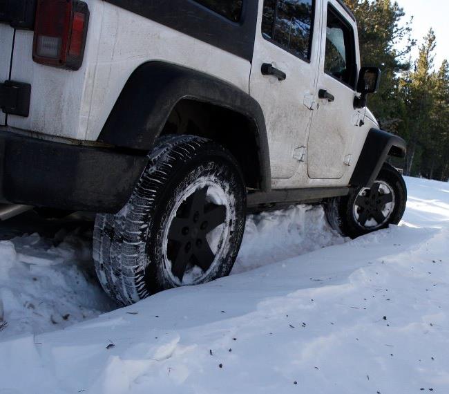

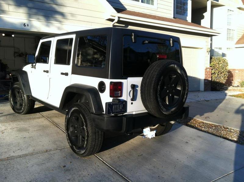

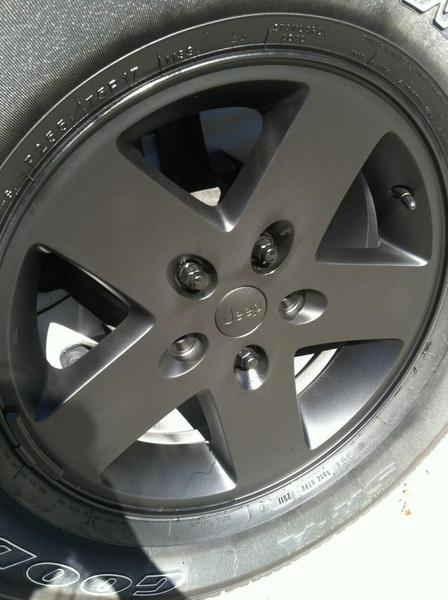

I Plasti Dipped my wheels, originally just did it so i could decide if i wanted to powder coat my stock wheels. That was about 2.5 months ago and its still holding up. Its held up offroading through snow and mud and held up against the stuff colorado puts on the road. Also has held up to the pressure washer just fine. The key is to put it on thick enough that its covered but if you put too much on it will peel easier
If it does scratch or peel it will be extremely easy to fix. Cost me only 10 dollars to do all 5 wheels. Eventually I will peel it off and get them powder coated but for now this works great

I'm probably gonna do my stock wheels this spring. Did you spray right over the lugs? or did you do the lugs separately and wrench them on after they set up?

Prep is the key I took my wheels off the jeep and cleaned them inside and out. I then aired down the tire and shoved index cards between the rubber and the wheel. I also used some extra lug nuts the cover the lug taper (I don't think the lugs would torque well with rubber there) I also taped off where the wheel mounts to the brake disc. I sprayed the inside first the the outside. Just make sure you have good light when you spray it so you don't miss any spots.

You only used 2 cans for 5 wheels! I used about a can a wheel.
