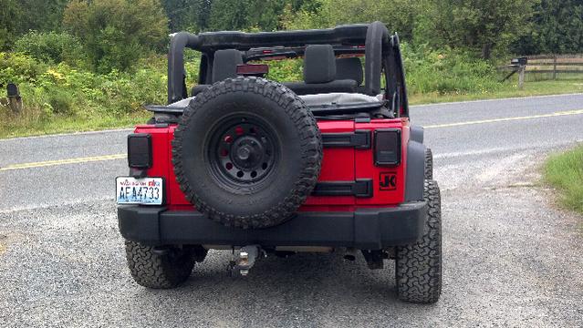

I didn't want to go super dark. It leaves kinds dark red really cool looking!
Heres a pic!

That looks awesome on your Jeep! Fits the red perfectly.

Yeah depending where you live also
I don't want anymore attention from the police lol and thanks! Hopefully get my lift on this week!

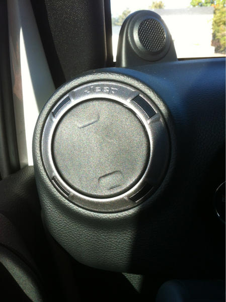

Does any one know how to take the vents off? I want to plasti dip them.

Turn them counter clockwise (might be clockwise) 1/4 way and gently pull straight out. Once you get the whole vent assembly piece out, you can pop off the vent rings from the vent assembly.

Inside the vents at about the 1 o'clock position you have line up the two squares and use a small screw driver and gently pry down on, turn counter-clockwise and pull right out. Be carefully not to break the tabs when taking the ring off the vent.
