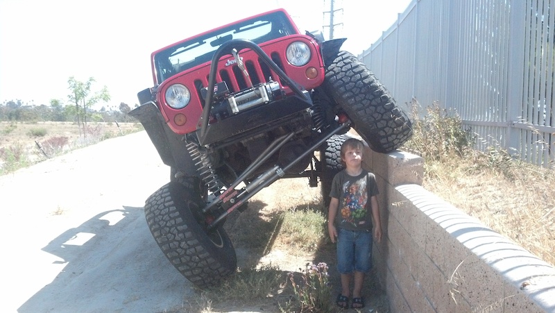

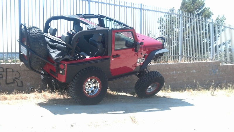

Playing around with my suspension again.

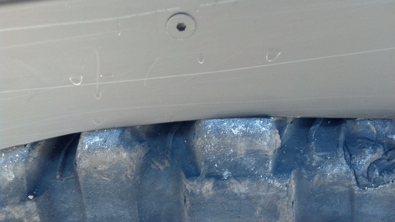

Originally Posted by JKphotoshoot
I am running 12 inch travel shock, using all the travel I can kill a factory driveshaft on the first trail I hit. Mine would pinch the metal band and split the boot.
This was where I was killing them.
Lol I got 2 that look like that right now 1 is on the jeep....yes first trail killed it....got 3 spares sitting in garage....my rear looks the same. Spun grease all over down there...looks like spots and not streaks...
And went and maxxed it out today....
And I was wrong I still need to drop the lower mounts down more....I put the tire into the wheel well which is the same height as the original inside line....it stuffed before maxxing out.
