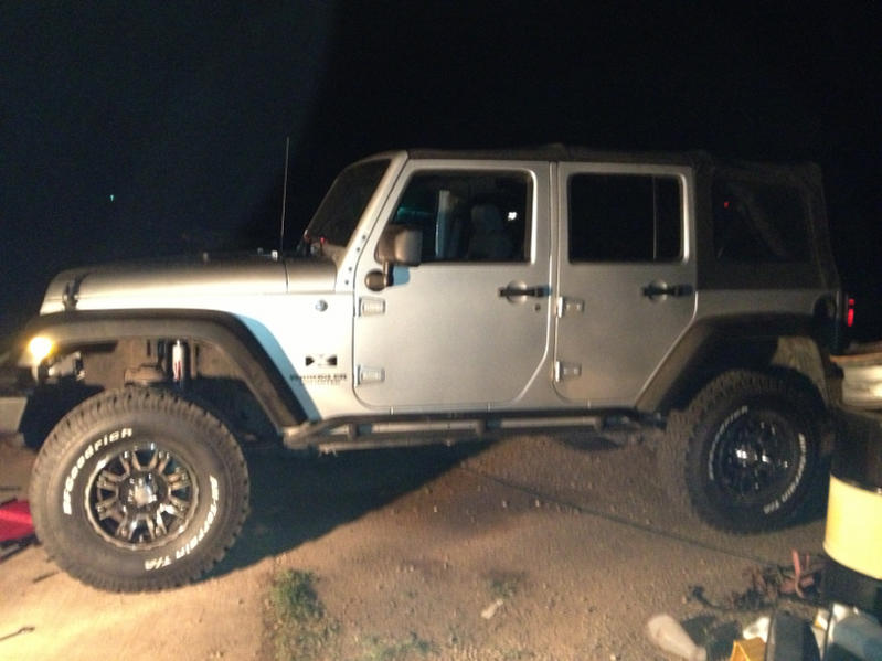

From this to this to this
ID:	371532   Click image for larger version
Old Sep 28, 2012 | 06:26 AM
1978cj7jk2012's Avatar
Posts: 1,611
From: Pawnee Ok
Originally Posted by 09jku
<img src="https://www.jk-forum.com/forums/attachment.php?attachmentid=371531"/>
Looks great! What sliders are those?
