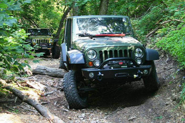

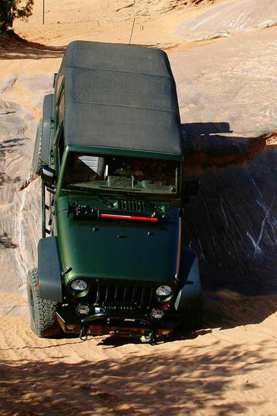

Oh, here is my Jeep back when I had a 2.5" BB (albeit with longer shocks) and 33s on 4.5" BS tires ...

Old Dec 30, 2013 | 11:31 AM
JK08MCS's Avatar
Joined: Dec 2008
Posts: 621
From: Redondo Beach, Ca.
Those are some nice wheels. Your going to wig if you hurt those wheel (not tires)
