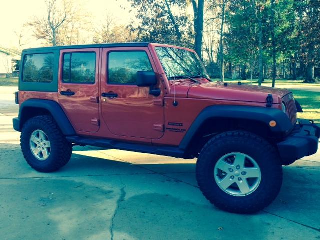

I also wanted some lift and wanted to be able to run a little bit larger of tire and have a daily driver with a close-to-stock ride...ended up going with rough country 2.5" series II, 1.5" spidertrax spacers (needed to not have any rubbing at full turn), goodyear duratrac 315/70 tires...I love it. I do notice a bit less power on the freeway though, because of the larger tires and auto transmission. Check out the pic.

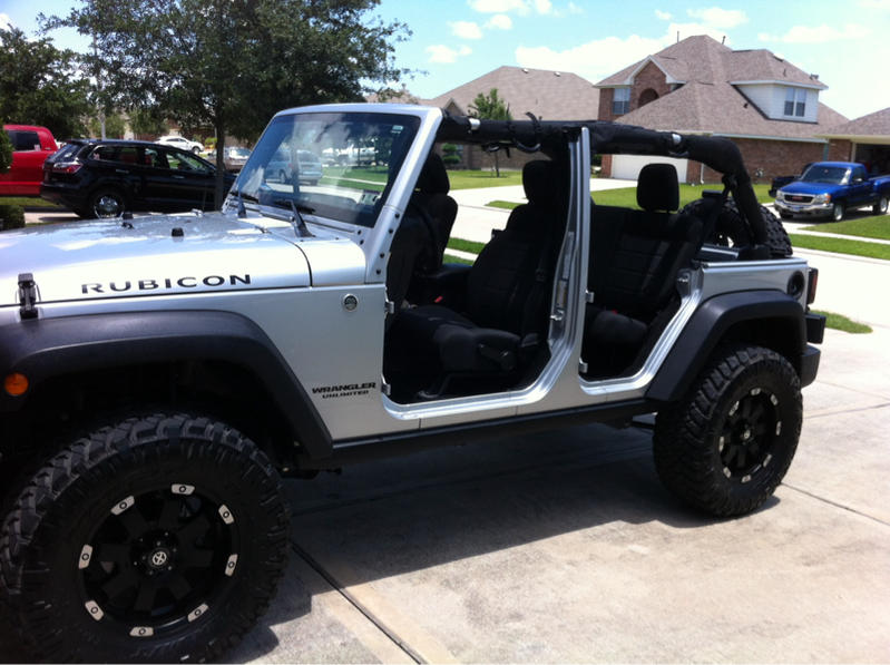

Here is mine when I had 2.5" TF coil lift and 35" tires.

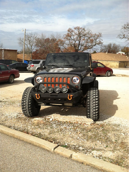

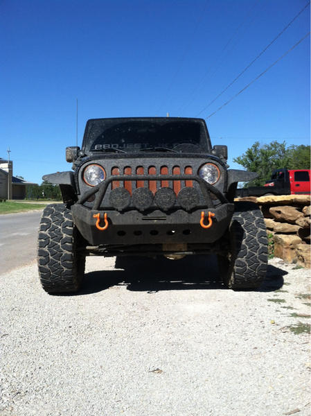

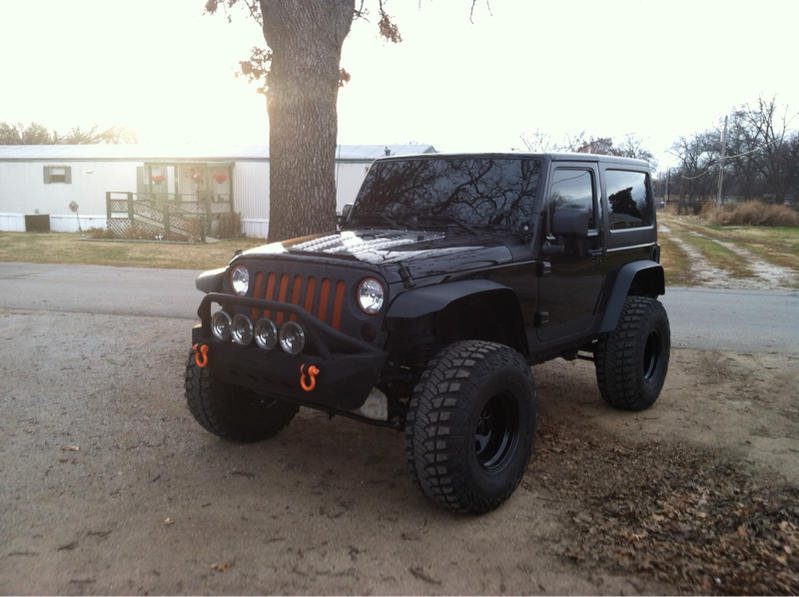

33s with rough country 2.5 inch budget boost with 4.75 inches back spacing on the wheels (lifts front and rear, front more)
Last three are 3.5 inch coil lift with 35s with 3.5 inch of back spacing on the wheels (front is also higher than rear because I like it like that)

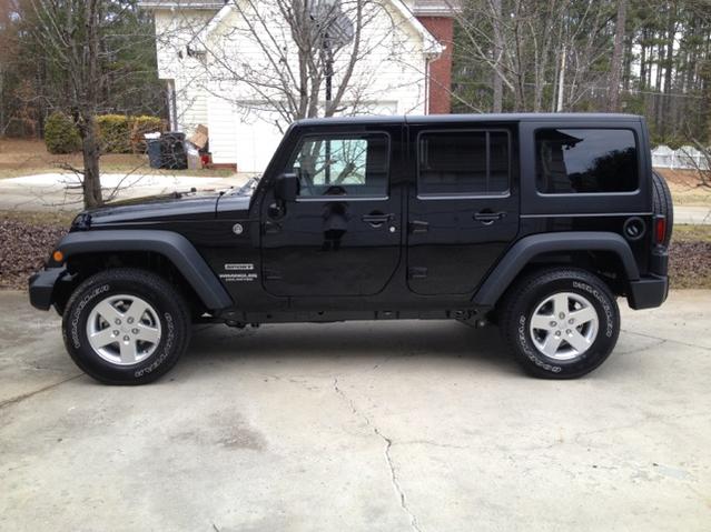

More Detailed- All I am wanting to do for now is level out my Jeep. I am going to keep my stock wheels and tires for now. My budget for the leveling kit is no more than $400-450 (not including spacers if I need them) I am also wanting to order the leveling kit and spacers (if needed) from quadratec.com -I have a 2013 Jeep Wrangler Unlimited Sport (4-door), Black
