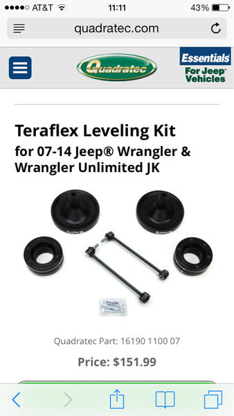

Just the basic leveling kit.

Originally Posted by kaylin_darling
Alright yall... I really appreciate everyones help and thoughts...oh and patience with me! Now I have some more questions...
What is the difference between these:
SkyJacker 2' Budget Boost Skyjacker 2" Budget Boost for 07-13 Jeep® Wrangler & Wrangler Unlimited JK - Quadratec
TeraFlex 2.5" Budget Boost without Shocks Teraflex 1355200 - TeraFlex 2.5" Budget Boost without Shocks for 07-14 Jeep® Wrangler & Wrangler Unlimited JK - Quadratec
TeraFlex 2.5" Budget Boost & Shock Adapters Teraflex 1355210 - TeraFlex 2.5" Budget Boost & Shock Adapters for 07-14 Jeep® Wrangler & Wrangler Unlimited JK - Quadratec
TeraFlex 2.5" Budget Boost with Shocks TeraFlex 2.5" Budget Boost with Shocks for 07-14 Jeep® Wrangler & Wrangler Unlimited JK - Quadratec
Do I need shocks? Why is the Teraflex more pricey than the SkyJacker? Are those ^^^ the right leveling kits I need to be looking at? What spacers do I need for my wheels/tires?
More Detailed- All I am wanting to do for now is level out my Jeep. I am going to keep my stock wheels and tires for now. My budget for the leveling kit is no more than $400-450 (not including spacers if I need them) I am also wanting to order the leveling kit and spacers (if needed) from quadratec.com -I have a 2013 Jeep Wrangler Unlimited Sport (4-door), Black
If you only want to level your Jeep then you really dont need any of the above. Some pucks to stick in your rear coils will level it out just fine. There are so many options it can be over load. TeraFlex makes a good quality product and seems to be more popular than Skyjacker. I have had the Teraflex 2.5" with coils and shock extensions and was happy. If you decide to go with 2.5" lift you should at a minimum get the shock extensions. I wound up upgrading to Bilsteins which made the ride better.
