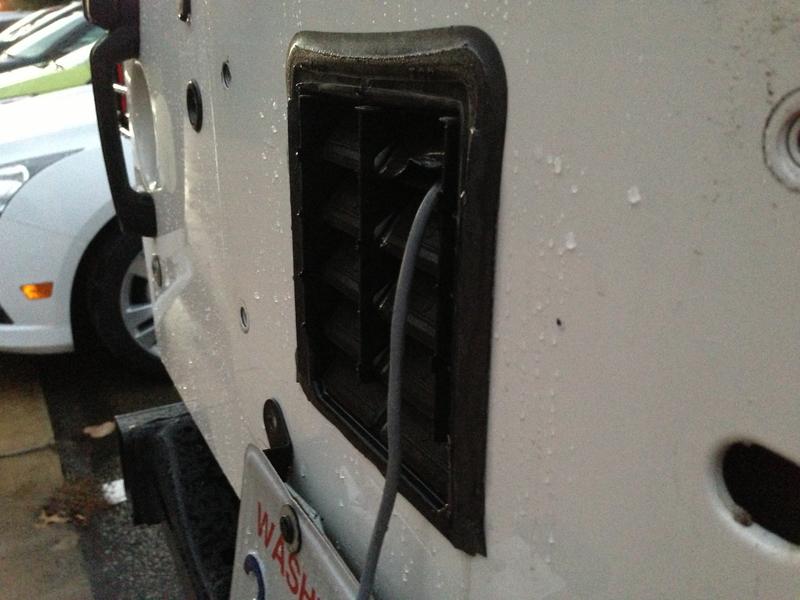

I have a narrow vent. All you have to do is trim the plastic rim around the vents. I just used a razor blade. Pretty easy. Just a few trial and error fits. I'll get a pic up soon. I also went with the ORO third brake light.

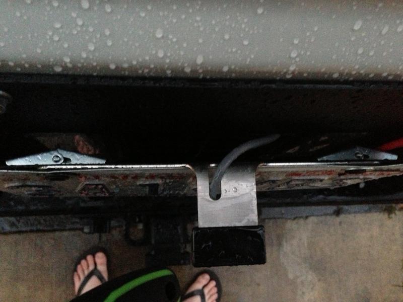

The ORO lite was pretty easy. You have to tap into the passenger tail light wires. I'll get pics up in the AM. The LEDs on the lite are super bright. 3 brake and 3 license plate. The Tramp stamp didn't come with anything to secure the plate to the bracket versus screwing into the stock bumper. I had some toggle bolts laying around that worked just fine.

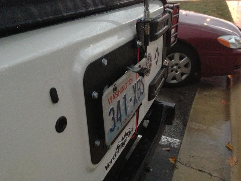

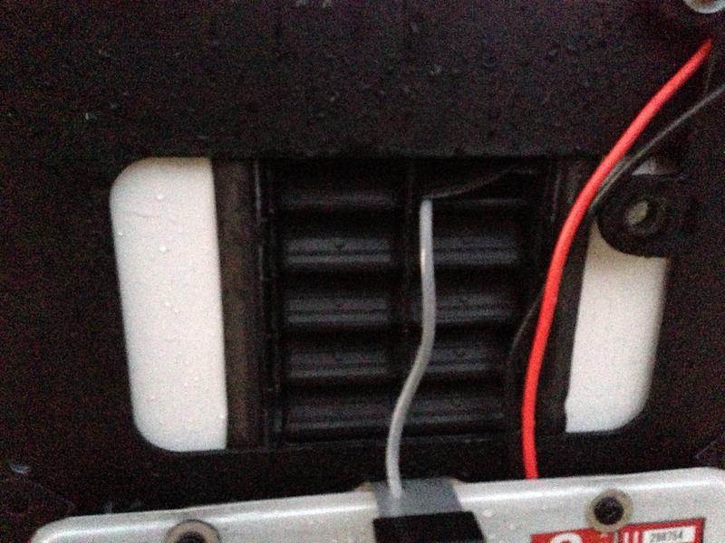

So here we go. Finally got them. I just trimmed the whole rim/ring of plastic off the edge of the vent. Did it like I was peeling an apple. Pretty easy. The hardest part (not that it was hard) was wiring the third brake light. Great instructions were given and easy to follow. Thanks Northridge. I also have the Teraflex antenna mount and it works seemlessly with it.
