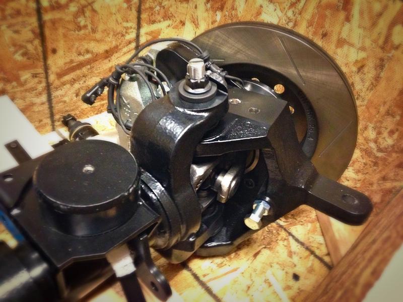

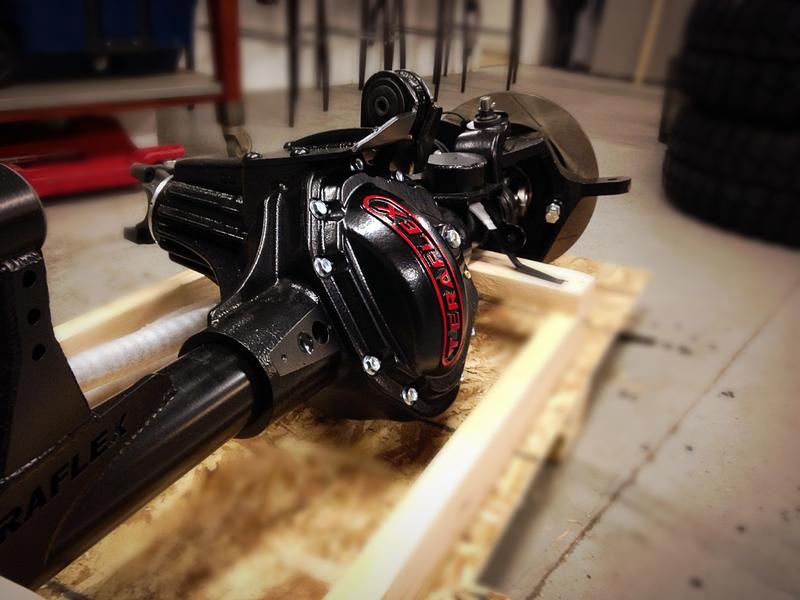

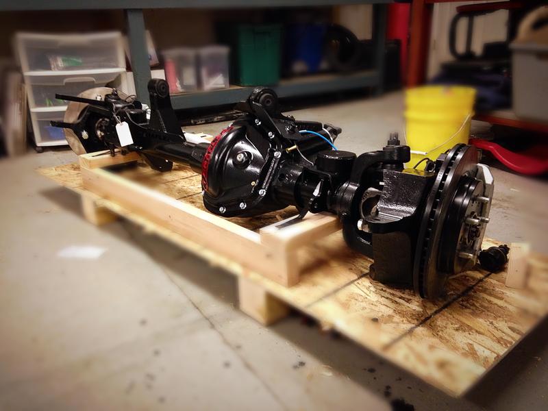

Have you looked into the TeraFlex CRD60? That's what we've got on the Offroad Elements JK... Comes with everything... Tie Rod, Drag Link, Big Brake Kit, Hubs, Monster Knuckles, axle shafts, and comes fully assembled w/ gears & locker... The setup with an ARB retails at $7,533.99
TeraFlex CRD60 Front Axle Assembly | Offroad Elements
