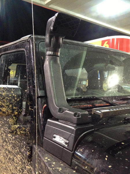

I went with the RR snorkel. Easy easy mod. I hate the look of the huge anaconda hood snorkel. Just my opinion. I wish i bought this 2 months ago. I hydro locked in about 2 ft of water. I hit it fast and i had a AFE cai. If u like water & mud, get a snorkel. Im sure they are all good but i really liked the look of the RR.
