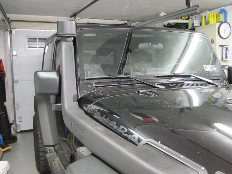

I guess I'm lucky. When I put my snorkel on I gained 2 mpg and that's figuring it out by hand. And if anything I had my foot in the throttle a little more afterwards cuz my seat of the pants meter felt some extra power :-)

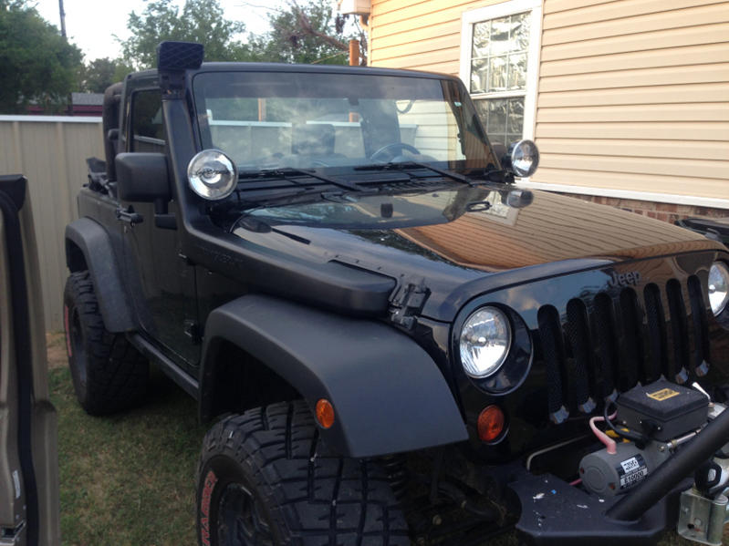

Default Donaldson TopSpin H002437
For those of you with the AEV snorkel there is another option to the pre filter they sell. The Donaldson TopSpin H002437 is a self cleaning system unlike the AEV pre-filter and looks cooler I think (especially if painted all black). Actually, Donaldson is the same company that makes AEV's pre-filter for them.
ht tp://www.amsoil.com/storefront/topspin.aspx
