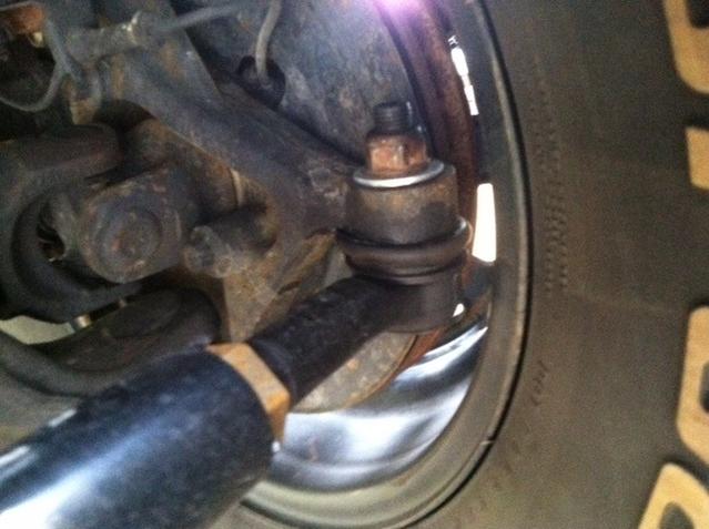

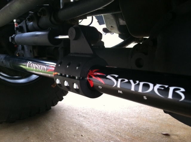

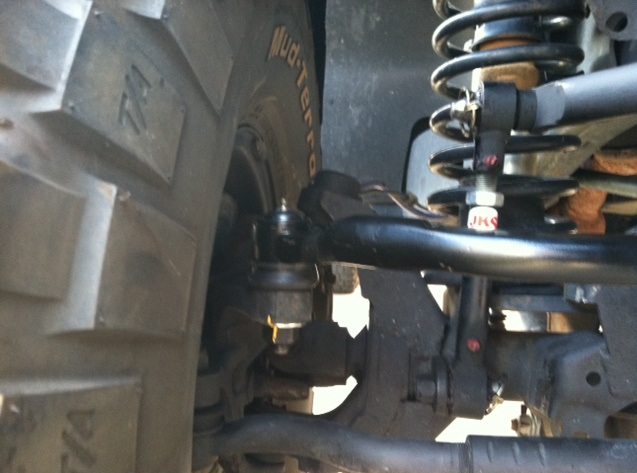

Im running 15x8 steel wheels but will replace them soon with 17" beadlocks. Couple things going with 15s is that you got to get the right backspacing, I have 3.75" and I barely had to grind down the front brake calipers. Try to stay away from spacers to get the right amount of backspacing. Also, upgraded my tie rod w/ the HD Pro Rock krawler and it barely fits, gets like 1/4" close to wheel weights. Combined with the right air pressure and tire mine rode pretty good in the highway, just don't take corners like a sports car and you should be fine.
