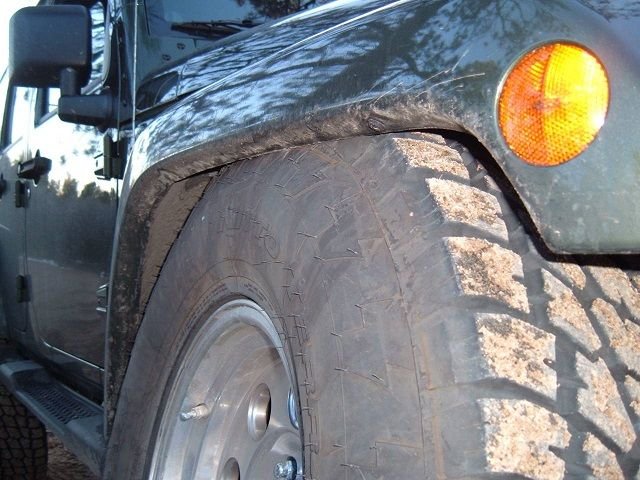

The contact area is the bottom lip of the flares, since the taller/wider tires are moved out far enough that they can no longer tuck up inside those stock flares. Makes sense, right?
As an example, this is 33x11.50's, 3.25" of actual lift height, 4.5 backspace rims. The tires were lightly rubbing in that pic -- going straight!! Turn the wheel, and that fender comes off...
You have options. Chop the flares, add taller bumpstops, add lift height, whatever. Just remember that all builds are different...

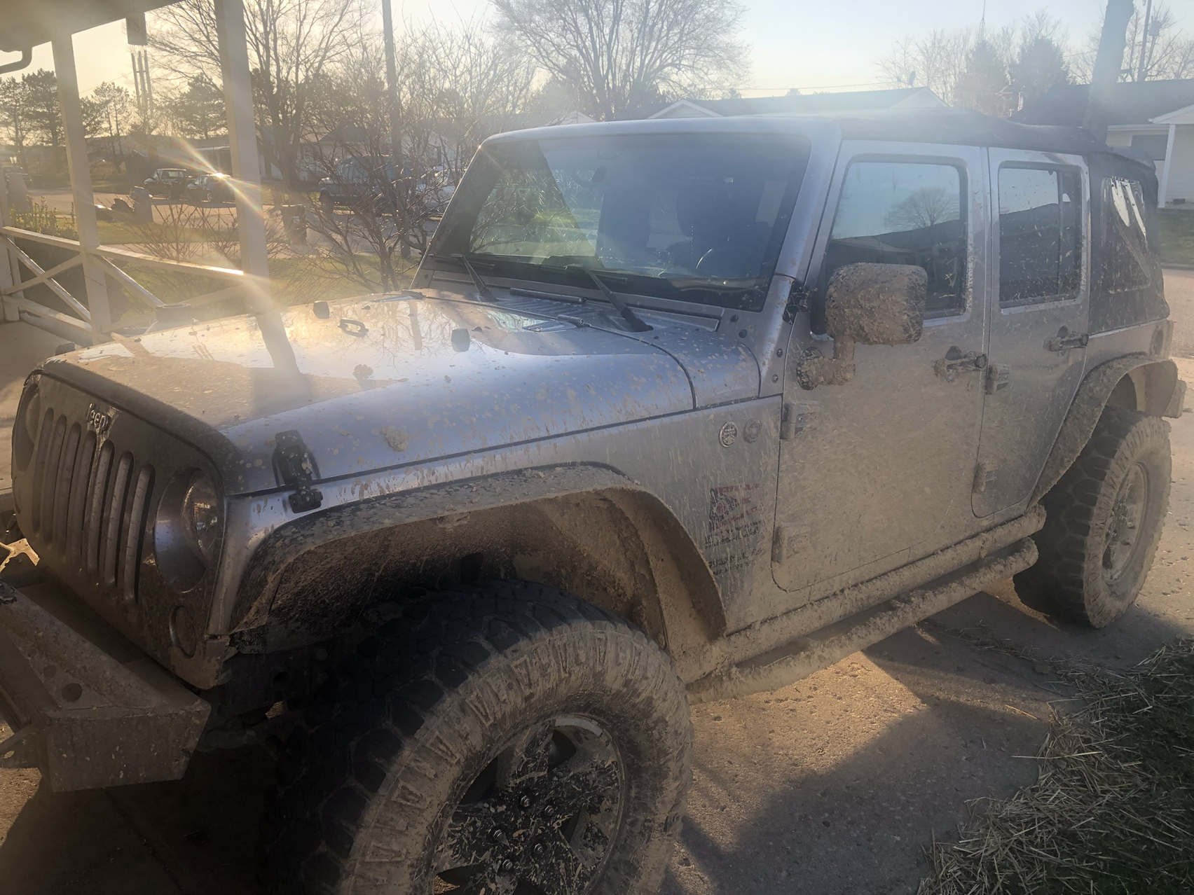

Flats with no lift and 35's

Thanks! Looks like I should be fine then. I don't think my stock fenders will interfere that much because I'm lifted up a bit

Yeah, my front rubs the swaybar at full flex and turned all the way to the right. And my rear rubs a little at full flex, but I haven't figured out where...I just heard it while wheeling last weekend and saw that my tread was cut ever so slightly. So with a minor lift you should be golden
