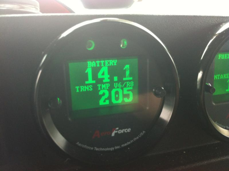

Thanks WOL, I think you nailed it. I have Aeroforce Interceptor gauges installed and while keeping an eye on the transmission temp, the ding occurred when it hit 180. I peaked around 205. What is the normal temp operating range for the 3.8L V6 auto?
I guess I may possibly need to install a trans cooler? Any recommendations?

Old Jan 23, 2012 | 03:02 PM
ronjenx's Avatar
Posts: 12,907
Likes: 185
From: Maine
Like I said, lots of theories, no real answers. I get the mystery ding when my transmission temp is below 120°F.

Old Jan 23, 2012 | 05:52 PM
TURTLECON's Avatar
Posts: 5,192
From: REDONDO BEACH, CA
Originally Posted by ronjenx
Like I said, lots of theories, no real answers. I get the mystery ding when my transmission temp is below 120 degrees F.
Hmmm you got a point there. Driving from work the ding went on but my trans temp read 105.
