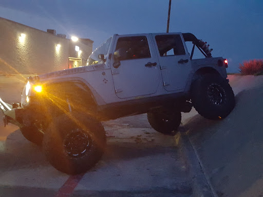

Haven't messed w the rear bumps yet. Was busy installing the pretty stuff ... grille, roof rack and lights. Hopefully get to it over the holiday weekend.
Old Nov 18, 2016 | 08:40 AM
Ripa777's Avatar
Joined: May 2014
Posts: 356
From: SoCal
