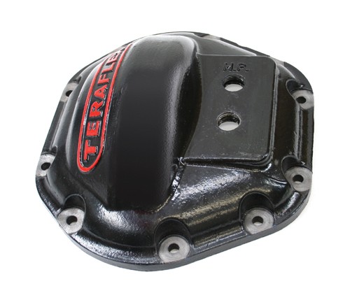

http://www.teraflex.biz/crd50r-and-d...ial-cover.html
TeraFlex diff covers are 3/8" high strength ductile-iron.
$99.99 for the D44
$89.99 for the D30
