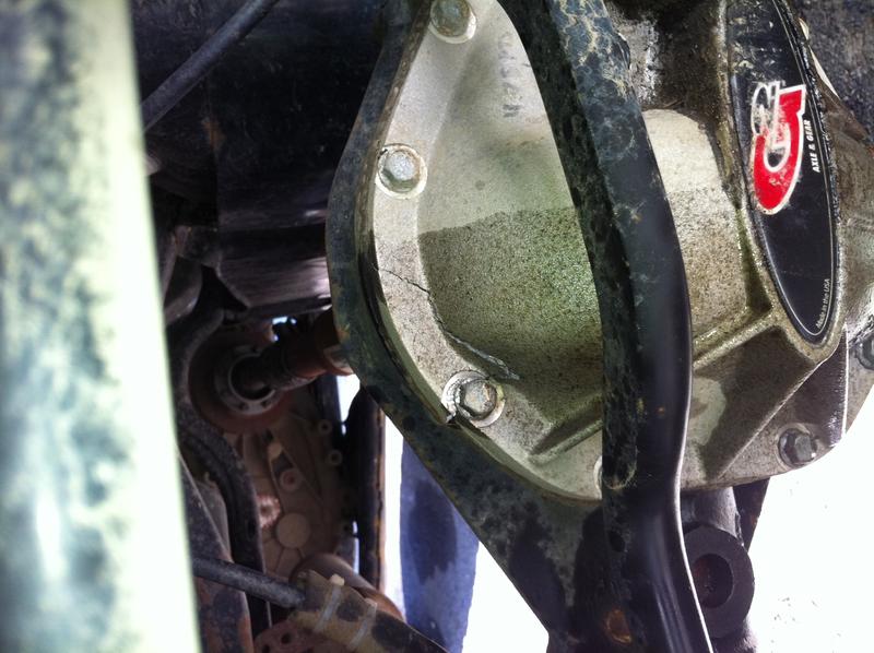

I still don't know how the G2 cover cracked the way it did. Looks like it stress cracked to me? A "V" shaped crack at the top, not a dent or a scratch on it???

Anyone seen damage like this before? The top is to the left, sorry it loaded like that. Not a dent or scratch on it, the wedge tore upward out from the bolt.

I sent G2 the pic above with a note and already recieved an email requesting my address so they can send me a new one under warranty. Said it was a strange break, I agree! At least they stand behind their covers. I'm upgrading to the iron ones I ordered anyway.
