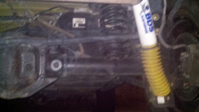

Old Jul 19, 2012 | 09:14 AM
cballz's Avatar
Posts: 67
From: Pasadena, MD
What do u guys think
