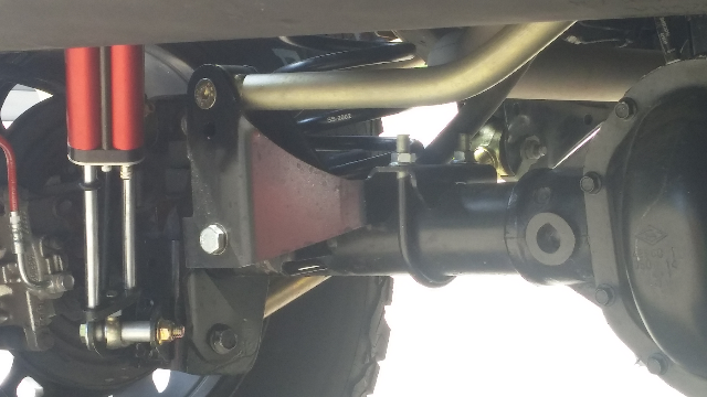

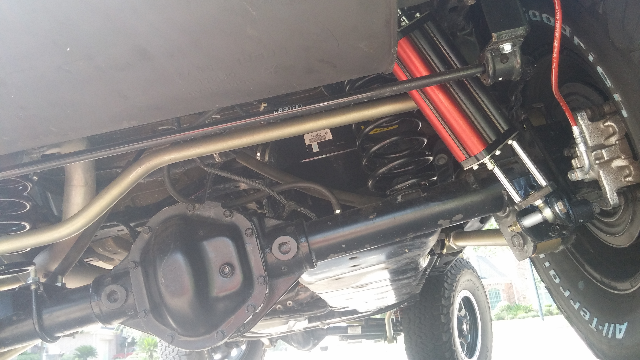

Originally Posted by dcm80401
Is the rear trackbar on rightside up? I know that mine is a different manufacturer. See my example.
Attachment 620512
Attachment 620513
Attachment 620514
Mine is AEV (Basically a stock unit) so mine looks completely different than yours?

Originally Posted by TheDirtman
Looks upside down to me as well. Looks like too much bump stop in the rear too. Did you just put on what was in the kit or did you check your clearances first?
I had a shop do the install (I a mechanical midget). I looked on Google and it looks like thats how all the AEV rear track bars look. I will definitely mention this to the new shop and have them check it out though

The important thing there is to have the mounting points as level as possible. Looks like they have a bend around the diff where most others bend the bar over it for clearance.
ok, when I drop it off I will definitely have them look at it. I am actually going to have them go through the whole suspension. I added Synergy lower control arms to the order this morning.

I was referring to the aev design with the bends. After looking at it some more it looks like it is mounted correctly. AEB just uses a unique design I am not use to seeing.
