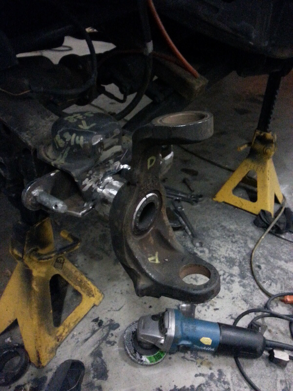

Originally Posted by VETTETHRET
Cool, thank man
Synergy uppers adjust stock, not sure on the lowers.
Put a angle on your pinion flange. Pinion angle will give you caster. Stock pinion is around 2° = 4° caster.
1° pinion = 5° caster
3° pinion = 3° caster
Total separation = 6°

Originally Posted by kjeeper10
Goodsgotacuda and Imped rotated stock 44 C's.
I think brute4ce did his also without moving all bracketry?
Old Aug 6, 2015 | 12:37 PM
  #44
kjeeper10's Avatar
Vet Army
Posts: 3,440
From: CT
I remember him blowing a u-joint/BJ and knuckle up.
Old Aug 6, 2015 | 01:07 PM
  #45
Maertz's Avatar
Posts: 4,482
From: Neenah, Wisconsin
Yeah and it bent the c so he put on new stock ones and rotated i believe.
Old Aug 6, 2015 | 01:33 PM
  #46
kjeeper10's Avatar
Vet Army
Posts: 3,440
From: CT
Pic from his build thread.
