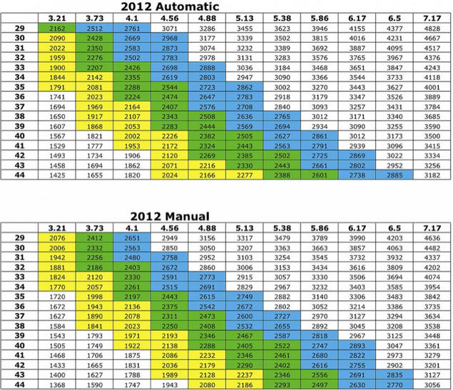

Well if your going to be opening your rears consider lockers now, I also have a 12, mines on 35's currently with 3.21's I just ordered 4.56 gears lockers master install kits chromoly front axle shafts sleeves and gussets for the Dana 30. If you pm me ill let you know how much and from who.
I went with 4.56 because on the 12 auto that puts me at 600 rpm more at 65 vs the stock set up
Look at the attached chart

Thanks for the chart that helps
